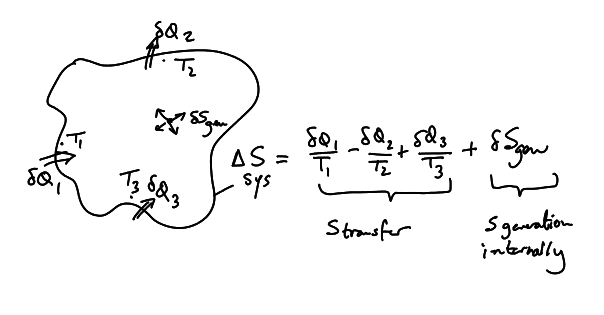

My question relates to entropy generation in a closed system
ΔS=dQrev/T for a reversible process
ΔS=dQ/T + Sgen for an irreversible process
This seems to suggest that Sgen arises because of the irreversibility of the heat transfer process (eg across a finite temperature difference).
If, however, we have reversible heat transfer to a system, but also some form of internal friction occurring (eg turbulence), can we say something like
ΔS=dQrev/T + Sgen(turbulence)
Also, if we have irreversible heat transfer and also frictional irreversibilities, does something like this apply?
ΔS=dQ/T + Sgen(finite temperature heat transfer) + Sgen(turbulence)
Or adiabatically, with internal friction
ΔS=Sgen(turbulence) ??
Thanks in advance. I'm finding its surprisingly hard to get a clear view of this apparently simple issue...

Again, I think you mostly have it but you need to be careful. When you are analyzing the universe (or an isolated system), there is no external heat transfer, and you can only say that change in entropy of the universe (or the isolated system) is due to internal entropy generation. Basically, realize there are three forms of the second law:
isolated system (universe): ΔS=Sgen
closed system: ΔS=∫δQ/T+Sgen
open system: ΔS=∫δQ/T+mass_flow_in*s_in-mass_flow_out*s_out+Sgen

Ok, I think I get this now. For a closed (dm/dt=0, but not isolated) system, I've drawn the attached diagram.
From the system's perspective, the external temperature(s) from which heat is transferrred into the system is unknown. This means that the dS-system equation is 'unaware of' any (external) irreversibilities to do with finite differences that may be driving heat transfer.
Please do let me know if I'm still in error, but this now makes sense -for which I'm hugely grateful.
(thanks also for the earlier reminder that all gradients, eg velocity gradients in laminar flow, being important to Sgen).
I think your diagram looks ok, except for a somewhat minor point: Instead of ΔS, it should be dS. In this form it will tell you the instantaneous change in entropy in your system. Alternatively, you need integrals on the other side of the equation. In this form it will tell you your change in entropy for your system over some integration time.
