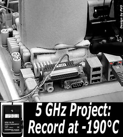

Here's a Tom's Hardware project that uses liquid nitrogen cooling to try and overclock a CPU to 5GHz:
http://www.tomshardware.com/reviews/5-ghz-project,731.html

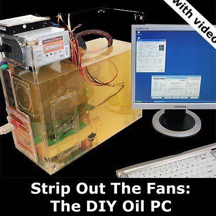

No need to use Fluorinert, you can just use vegetable oil like Tom's Hardware did :tongue2:
http://www.tomshardware.com/reviews/strip-fans,1203.html
A combined PC and donut maker - mmmm !
