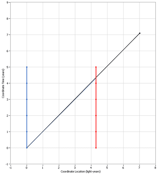

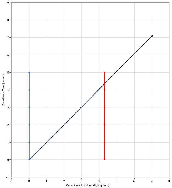

The calculations are based on the Lorentz Transformation. I have drawn a couple spacetime diagrams to show you the results. First a diagram showing Earth as the thick blue line with dots spaced one year apart, Alpha Centauri C as the thick red line 4.3 light years away from Earth and a spaceship as the thick black line traveling for one year of its own Proper Time. I have also shown a light signal as the thin blue line just below the spaceship sent to the star:
As you can see, in the earth-star rest frame, it takes just over 4.3 years for the spaceship to get to the star at 99%c.

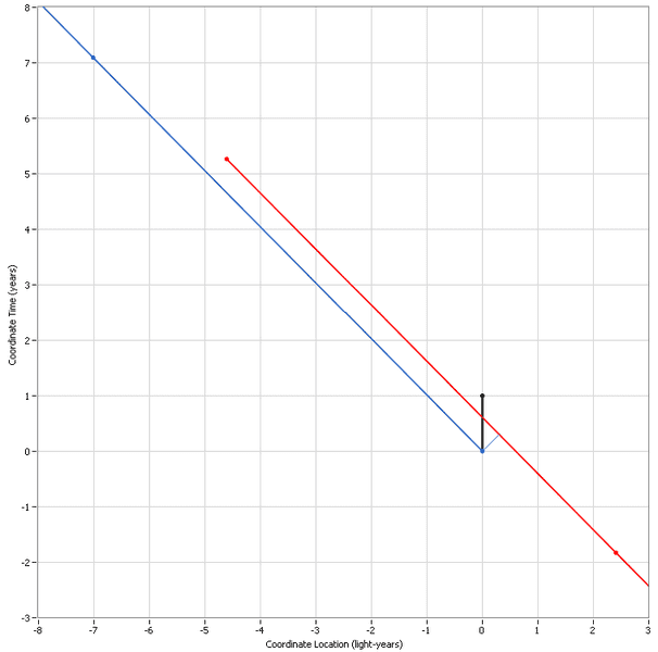

Now if we use the Lorentz Transformation process to convert to the rest frame of the spaceship we get:
Now the distance between the Earth and the star is contracted and so the spaceship can get there in just over 7 months.
