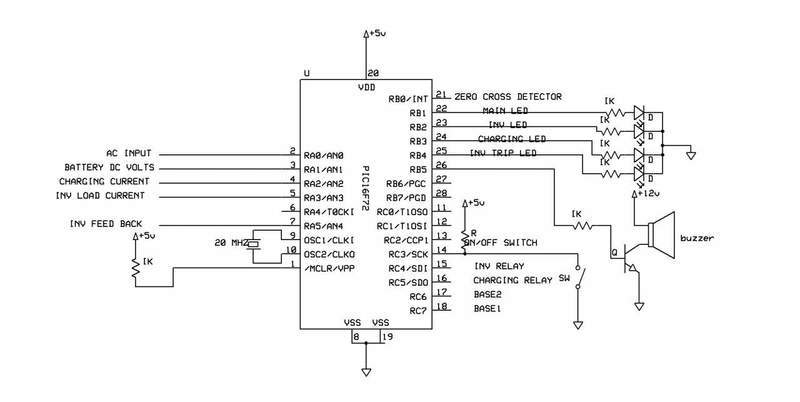

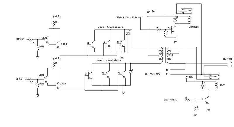

UPS circuit PIC
An uninterruptible power supply, also uninterruptible power source, UPS or battery/flywheel backup, is an electrical apparatus that provides emergency power to a load when the input power source, typically the utility mains, fails.
The circuit diagrams are given here the code is not provided.
Regards,
Jazib.
