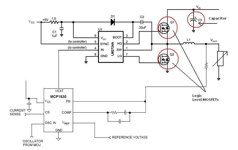

I'm a newbie trying to figure out a few crucial additions to my circuit I'd like some tips and suggestions..
Basically, I'm building a circuit that will produce a constant current to variable loads, I'm using a buck-converter model with a supply of around 10V, the inductance should be around 10-20µH with a ripple current of about 1A and a total constant output current of 50A.
Currently I'm using a LM2724A dual-MOSFET driver and an MCP1630 PWM source to control the switching of two MOSFETs. I need help with selecting an appropriate input (coupling) capacitor and the correct logic-level MOSFETs to complete the circuit.
Any suggestions for these two components? I need to look at ripple current and ripple voltage rating of the capacitor...and I'm not sure if the MOSFET current (ID) should be rated at 50A or if a lower value is acceptable?

A circuit drawing would be helpful, or link to the MCP1630 data sheet if it has an appropriate app schematic.
Hey,
Yeah, I should've thought of that before! thanks...
I've attached a circuit design..and the links to the datasheets of both the MCP1630 and the LM2724A...you reckon I follow the other standard capacitances as provided in the datasheet yeah?
MCP1630 - http://www.datasheetcatalog.com/datasheets_pdf/M/C/P/1/MCP1630.shtml
LM2724A - http://www.datasheetcatalog.com/datasheets_pdf/L/M/2/7/LM2724A.shtml
you could also take a look at this datasheet of MCP14628 dual-MOSFET driver which I opted for previously..it has a neat design with the MCP1630...I had to change this microchip due to unavailability.
MCP14628 - http://www.supplyframe.com/datasheet-pdf/component/microchip+technology/MCP14628EMF-datasheet&partId=1974675 cheers!
C3 is an input filter cap, if that's what you mean. The supply may already have an output filter cap. If so, C3 can be used to take up the slack for peak current into the inductor. There are also current spikes at switching-time. For this you might want a low ESR filter capacitor (mica would be a good choice) in parallel with C3. The 10V source could be from something like an LM317 which doesn't like a lot of output capacitance. So the selection is dependent on the 10V source.

That's confusing. To couple what to what?
I don't see any current sense going on. The feedback looks like it's sensing voltage.
Passing through the inductor is a DC + triangle wave current. You might want to filter the AC component with an output capacitor in parallel with the load, but electrically close to the inductor.

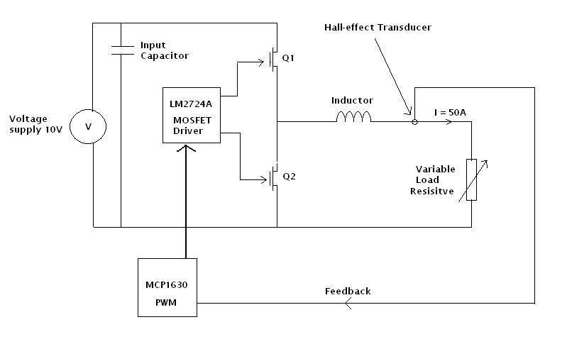

I completely forgot!
I will be using a hall-effect transducer to measure the current through the inductor. Then this will have to be used to convert to the voltage reference for the MCP1630 as stated in the diagram I provided.
I need to know how to work out the input capacitance value...could you suggest any methods?

First of all, that is not what is shown in your schematic. As Phrak says, you show voltage feedback from the load, which will not give you anything like a constant current output. You need to re-draw your schematic with the Hall sensor and it's smoothing/compensation circuit, before we can be of much help. And you should be clear about how you are simulating the control loop with the Hall sensor's response Bode plot included in the loop -- what is your phase margin with the Hall sensor in the loop? What does your new compensation circuit look like?
Also, why are you using a Hall sensor on the buck inductor? Is that traditional in higher-power current-mode buck converters, as opposed to the traditional low-side sense resistor below the load? On Semiconductor makes a current mode buck IC with a lower sense voltage to increase effiiciency (it's used in their LED driver circuits).
Redraw your schematic, and let's see what you have.

I'll see if I can work on the full schematic and attach it here soon! I'll need to bug my supervisor for more information now...thanks guys!
hey...
I've attached a simple diagram of what the entire cct will look like...all ideas and suggestions are welcome...please give your opinions about the best way to design the cct..
thanks!

I thought *you* were supposed to be designing the circuit... We don't do your work for you, whether in homework, coursework, or projects.
What is your training in DC-DC converter design? Why were you given this project, if you don't know how to do the design? I've let this thred stay in EE up to now, but that doesn't mean that we will do your work for you.
What are you planning for your unity gain crossover for the feedback loop? What phase margin are you shooting for? What are the characteristics of the load, and what kind of load regulation will your unity gain crossover afford?
Everything designs around the choke. Pick one. What do the current-voltage waveforms look like at steady state, start-up, and under dynamic load?
Edit: nevermind. This has been going on so long, i'd forgotten you gave a value.

the load is assumed to be purely resistive..I haven't worked out any of the feedback parameters...like I mentioned before, I'm currently working on the design of the buck cct only..sorry for the lack of info on this part...

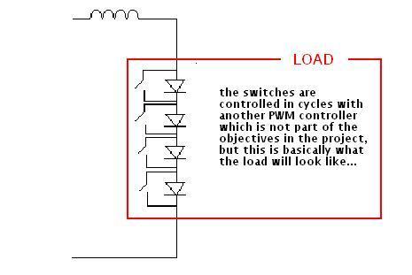

I'm supposed to consider variable loads but the example given to me is attached, it is a set of by-passed diodes in this case, but I shall ask my supervisor more details about the load when I see him next..they are basically devices under test (DUTs)
