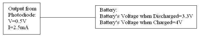

How to increse the voltage of output from photodiode, so that the voltage is higher than battery's voltage?
Remarks: Only can add-on passive components; active components are not allow.

Why do you want to do this? The chances of damaging the battery are so great and the chances for any success so small.
This is my school project. I have no choice.
Got any way to increse the voltage coming out from photodetector?
Why the chances of damaging the battery are so great? How the battery gets damage?

Excuse me if I sound critical. I understand your plight and sympathize. But, what school do you attend that would give this as a project?
Leaving aside the question of whether a photodiode is active or passive (the heuristic definition of active is that current is controlled by an electrical signal and then we all get to argue over whether light constitutes an electrical signal), the only way I can imagine doing something like this is a group of photodiodes. Or, you could use modulated light (a chopped beam would probably work) and then feed the output of the photodiode into a transformer, rectify it, filter it, and try that. Even Rube Goldberg would roll his eyes at that one.:rolleyes:
As an aside (since you need to get a good grade), try chatting with this teacher to see if he (she) has in mind a solar array.
