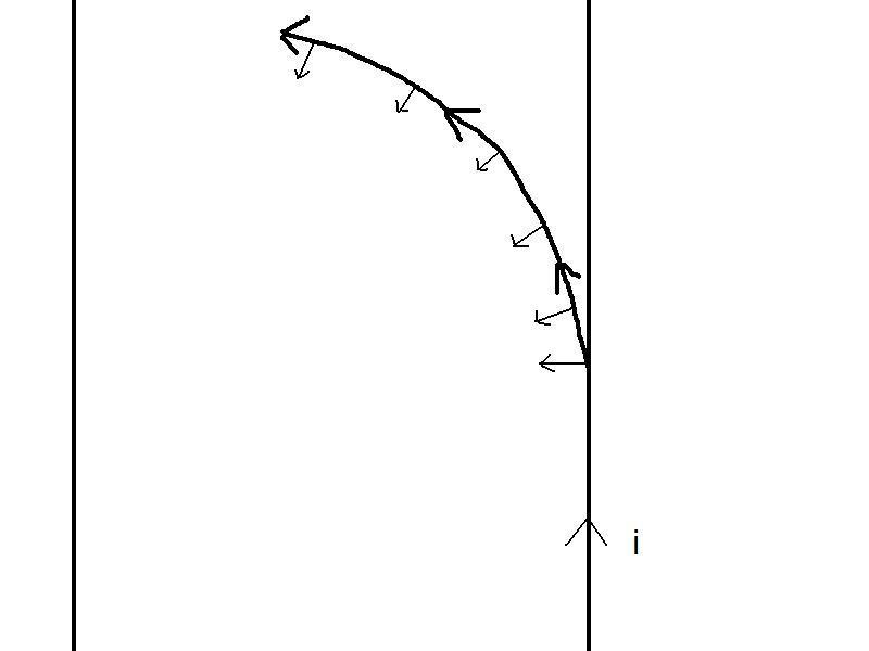

Consider Statement A: If an object X moves in any direction which is not perpendicular to some force F, then the work done by F on X is nonzero.
Is Statement A true or false?
Consider the situation where there are two parallel current-carrying wires separated by some distance d, each having a current of magnitude I and pointing in the same direction. For simplicity, let us assume that the currents are going from the bottom of the page to the top of the page, and that the first wire is to the left of the second wire.
Now consider Statement B: By the Biot-Savart Law, the magnetic field due to the second wire at any point on the first wire is directed out of the page.
Is Statement B true or false?
Now consider Statement C: Since the magnetic force on a current-carrying wire is proportional to [tex]\vec{I}\times\vec{B}[/tex], by the right hand rule the magnetic force on the first wire due to the magnetic field of the second wire is directed to the right (that is, towards the second wire).
Is Statement C true or false?
Now consider Statement D: As a result of the rightward force it is experiencing, wire 1 will move to the right, i.e. closer to wire 2.
Is Statement D true or false?
Now consider Statement E: The direction in which wire 1 is moving, which is to the right, and the direction of the magnetic force acting on it, which is also the right, are parallel, which obviously means they are not perpendicular.
Is Statement E true or false?
Finally consider Statement F: Since wire 1 is moving in a direction which is not perpendicular to the magnetic force acting on it, by Statement A the work done by the magnetic force acting on wire 1 is nonzero.
Is Statement F true or false?
If you think that Statment F is false please point to the earlier step in which I made a mistake.
Any help would be greatly appreciated.

Obviously the direction of the magnetic force will change as a function of time. But the important thing is that, at least initially, the wire will move in a direction that is not perpendicular to the magnetic force acting on it. Therefore SOME amount of work, however small, must be done by the magnetic force due to the second wire.
Statement F is true.
Suppose the two wires are in the x y plane, and the currents are in the y direction, and wire 1 moves in the x direction.
The stored energy per unit length in the system is
W = (1/2)LI2,
where L is the inductance per unit length.
The force Fx= dW/dx = (1/2)d/dx( LI2) = (1/2) I2 dL/dx + LI dI/dx.
Since I is a constant, the second term is zero, so we have
Fx = (1/2) I2 dL/dx
So the motion of the wire is reducing the stored inductive energy.
The electrical energy was due to a voltage pulse V = I dL/dt + L dI/dt , where the second term is zero.
Statements A through E are also true.

The magnetic force is NOT in the direction of displacement. You are being confused by saying that current is in one direction, and then saying that it's moving in a different direction. It's redundant to say a current is moving. Current IS movement (of charges).

DRUM, you need to brush up on the basics of electrodynamics. First, work is defined as the application of force over a distance, the integral quantity
[tex]W = \int \mathbf{F}\cdot d\mathbf{\ell}[/tex]
When the path of displacement is not along the force vector, then the work done is zero. It is obvious from the Lorentz force that the contribution from the magnetic field gives rise to zero work. The displacement is along the velocity vector yet the cross product of the velocity and magnetic fields means that the force vector will be normal to the velocity vector. This can be seen most easily in cyclotron motion. If I have a charge moving at some velocity v in a constant magnetic field applied perpendicular to the velocity, then the charge will be induced to move in a circular orbit. And just like a mass on a string being revolved in a circular orbit, the force on the charge is always pointing towards the center of the orbit, causing the work done over any length of path to be zero.
Maxwell's equations satisfy special relativity, indeed they helped to directly precipitate the derivation of the theory. As such, we are often at home working with electromagnetic fields in the Minkowski space through the use of four-vectors, covariants, tensors and such. In this respect we see that electric and magnetic fields are purely a matter of reference frames. They are equivalent to each other in the respect that they always exist together (I just mentioned Jefimenko's equations in another thread that gives one insight into this) and that by manipulating the reference frames one can induce the magnetic field from a electric field. The calculation of the magnetic field from a line of current using Lorentz transformations on the electric field of the charges in their frame is a common undergraduate physics problem in electromagnetics. I am sure you can find the appropriate derivations in say Jackson or Griffiths.
Displacement is not along the force vector. The force vector is the direction of acceleration. As I mentioned previously, if you take the electron in a cyclotron you can see most clearly that the force vector is normal to the path of displacement at any point. And again, we can see that the magnetic field's contribution to the force does no work because of this. We can even see this explicitly with the wires, the movement of the charges are perpendicular to the force for our given static initial condition. In this case, it is apparent that the work at the initial condition is zero since the force is being applied normal to the path of displacement of the charges at that moment.
And no, there is nothing where classical electrodynamics can explain a phenomenon where relativistic electrodynamics cannot. First, classical electrodynamics satisfies special relativity already, there is no modification needed to the theory for them to agree. As such, careful examination of classical electrodynamics will give rise to the Lorentz transformations (as they did originally for Lorentz when he derived them) and you can then apply them to show the equivalence between the electric and magnetic fields. Once again I can only implore you to pick up an undergraduate electrodynamics textbook and familiarize yourself with relativistic electrodynamics. However, your confusion of acceleration with the path of displacement also suggests that you may want to also work out a few simple trajectory problems to refamiliarize yourself with the basic mechanics of the problem. Force only points along the path of displacement for special conditions, the primary one being when the current velocity of the mass is zero.

The Lorentz force does not act on the wire because it only acts on charges. This means that the displacement over which the Lorentz force acts is not the direction that the wire moves. The displacement is determined by the trajectory of the charges that represent the currents in the wire. The wire moves because the displacement of the currents causes a Coulombic attraction between the static ions of the wire's lattice (since the ions do not move they are not affected by the initial magnetic field).
The question here is whether or not magnetic fields do any work, and the attraction and repulsion of wires is a common example brought up in regards to this question. In this case, we can see that in the initial conditions, there is no work being done by the Lorentz force. This is because the magnetic fields are applying a force that is normal to the path of displacement of the moving charges.
However, there is work done because the problem is not a static problem, since the magnetic fields are time-varying we introduce time-varying electric fields which we can trivially show that the Lorentz force from an electric field can perform work on a charge.
Classical electromagnetism follows special relativity. This allows us, by judicious choice of reference frames, to work a problem only involving electric fields. With the insights from special relativity, or other formulations of classical electromagnetics, we see that we can think of having an electromagnetic field, as Hootenanny put it, as opposed to electric and magnetic fields.
As for your repeated requests for explanations, if you take a look at any reference material you should see examples addressing these situations. Indeed, in the Griffiths text that I suggested earlier he deals with the problem of two lines of current and reformulating it as a purely electric field formulation.

What is the direction of Lorentz force then?
What force do you suggest is responsible?
Please see the attached picture. The trajectory is just off the top of my head so it should not be taken to be exact but this is the general shape of the path as I see it. The Lorentz force due to the magnetic field is shown in the thin arrows (magnitudes not to scale). The thick line is the displacement path.
This ignores the Lorentz force component from the resulting electric fields though. Perhaps it would be more instructive of you to ignore the actual physical wire. Treat the problem as I suggested earlier, as a stream of electron gas. Just assume that we have a line current of free flowing electrons. What is the displacement path of one of the electrons or current elements? Why don't you draw that out?
  • #34
Yes, it is plain to us that you do not understand what is going on with this problem.
If you do not understand how the trajectory that I drew arises with an electron gas then you sorely need to brush up on your mechanics. Once again, you should sit down and work out the cyclotron problem and from that realize how the trajectory arises and why there is no work done in that situation. The same situation is applicable here though there are additional caveats that can be ignored for the current purposes of teaching the basic electrodynamics.
There is nothing that we can do for you until you take the time to learn basic electrodynamics. Your refusal to to look at the problems that we have suggested and looking at the reference materials that have been suggested to you in many of the previous posts is preventing you from understanding this discussion.
