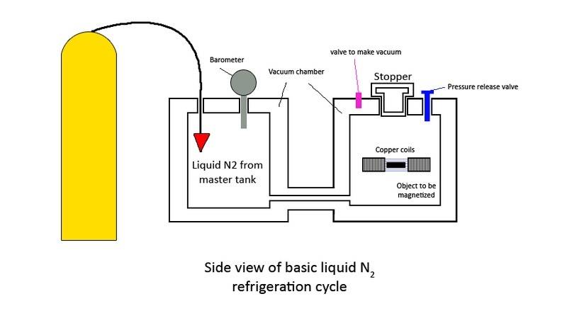

Hello all, I'm in the process of designing my own electromagnets, and would like to know the benefits(if any) of using superconducting wire at 77K( liquid nitrogen cooled) rather than an equivalent length of copper wire cooled to those temperatures in creating a solenoid.
Because the critical current of commercially available High Temp Superconducting wire at 77K is only around 120 A, and the thinnest diameter i can find is about 3mm, am i better off going with regular copper wire and using higher currents and just cool it with liquid nitrogen(or some other system, I'm thinking liquid N2 might be unsafe due to a fast rate of evaporation)? Is the magnetic field produced by a superconductor at a given current much larger than that in a copper coil at the same current? Or is it the same?
Also, if the field produced is larger, how much larger is it and why is it producing a larger B field?
The field is the same--its still simply directly proportional to the current. The type of conductor doesn't matter--unless it has other magnetic properties like ferromagnetism, etc (and neither copper nor common superconductor material have such attributes). Maybe try a copper pipe and run the coolant through it-that way water might work fine. Not sure teeny copper pipes are easy to come by, though! I take it you need magnetic intensities above the flux density saturation of any known material, since you didn't mention the idea of a core? This thread has a couple of interesting points: https://www.physicsforums.com/showthread.php?t=238353
ok i thought as much but wasn't thoroughly sure. i will revert to copper wire for practicality. i have attached a draft idea for my N2 refrigeration unit. I was wondering as well the length of time a strong magnetic field must interact with a ferromagnetic material before saturation occurs in the hysterisis curve, and how can you determine when this point is reached?
Oh i will be using NdFeB as my core material.

Oh i just realized that the attachment showing my cooling plan is still pending approval. My plan is not to use hollow wire, but thin regular wire, and essentially create a refrigerating box(with a pressure release valve) to house the setup in.

I just realized that i only have to run the current for something like a few ms to achieve magnetization, so heat should not play a huge factor, my biggest worry now will be the breakdown current. if need be i can try to fit more coils and drop my current to safer levels.
Also, since I only have to run the current for a very short time, and since I'm doing this at home, i think that the most practical way to cool the wire would be to place the current generator, coil, and ferromagnetic material into the bottom of an open steel drum, pour some liquid n2 in, and run the current. It'd look pretty cool too cus there will be a huge cloud of vapour caused by the current evaporating the n2.
*note, the only reason I'm bothering with the cooling is so that my wires don't melt on me, do you guys think that i could forego the cooling since my time of operation is going to be so low(about half a second)*
