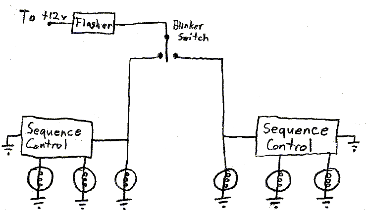

Im trying to design a circuit that will delay the turning on of a light.
I have three bulbs, one should turn on as soon as power is applied, the next should turn on in X amount of time after the first, and the final light should turn on in X amount of time after the second.
Basically like this
[on][off][off]
[on][on][off]
[on][on][on]

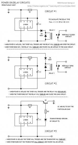

I believe ther center circuit in the picture I am attaching is what i need to use and i picked one up from radio shack but i don't have some of the other parts i would need (all i have are some various resistors and capacitors and other odds and ends from my circuits class)
So what would you guys reommend doing? I can't seem to find a formula to calculate the proper values of the resistors and capacitors so that the time X will be the value i need it to be.
Here is what I am trying to accomplish

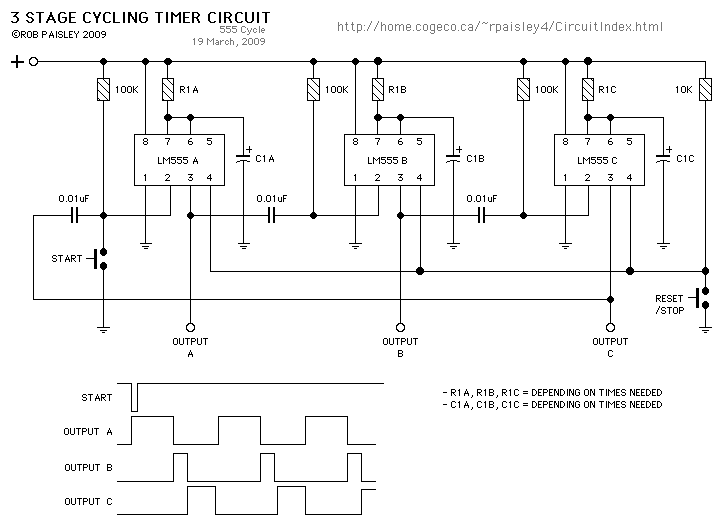

ahhh interesting... from the same site as the OP's ccts :)
just looking at the timing tho... if I read it correct... it doesn't match what Shadow is trying to achieve... see the taillight animated gif in his first post.
the timing shown shows that the following timer doesn't trigger till the previous one switches off.
Rather what is needed is just 3 independant timers starting with the same trigger ...
1st timer triggering immediately but not switching off till end of full cycle
2nd timer triggering after a delay but not switching off till end of full cycle
3rd timer triggering after a longer delay but not switching off till end of full cycle
at end of full cycle all 3 switch off and start sequence over again
Dave
considering that the start pulse is supplied by activating the turn signal level...
1) can the three pin 2 trigger inputs be tied together and just use the single .01 and 100k as shown above the "start" switch or does there need to be some isolation ?
2) would/could you need/use a 4th timer to trigger the reset automatically, till the turn lever resets to centre position after completion of the turn ?
as far as i know when the turn signal is applied the tail lights receive a pulse of power, where are the brake sends a constant power supply. If that is correct then i only need to set it up so that the time it takes for all three lights to turn on is <= the turn signal pulse so that it will sequence each time it is powered but will remain on after 1 sequence when the brake is applied.
here is a video on youtube of how they should work. I am trying to recreate this exactly

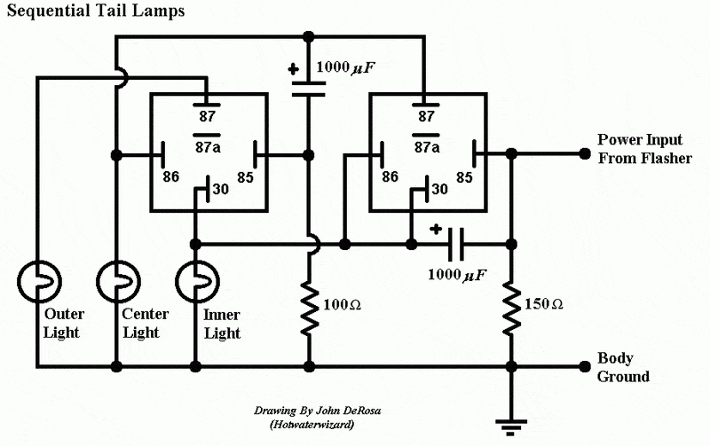

Some more googling revealed this diagram.
perhaps this would be better for my application? I am trying to keep it as cost effective as possible and i don't have much knowledge in electrical engineering (im mechanical)
also with the diagram i just posted is that something i could build on a breadboard with 3 leds to test it out? The circuit looks fairly simple compared to some I've put together but i have no knowledge of what kind of currents and voltages i could use to test this on leds and then use on tail lights aswell
