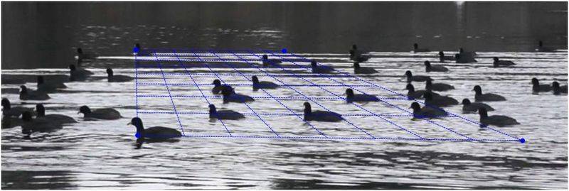

Hi Chiro. Thanks so much for responding! I've attached a photograph to show what I'm looking for. Hopefully you will be able to access the photo. On it I show a standard measure of a bird (American coot) at 37cm, and the red angle line(s) to the bird I want to find the distance to. The angle shown was just my attempt to try a small angles measure to get the distance, so ignore the angle, but the red lines show the distance I'm hoping to measure.
Basically I want determine the area in sq meters so I can figure out the density of this group of birds. I have a good measure of the length, I just need the second dimension to be able to determine the area. Thanks again for your help!

Hello, Hugh,
I was going in the same direction as chiro's. Your question falls in the subject called 'photogrammetry' (literally, taking measures on photos). You may do some calculations if you know your camera's CCD sensor size, for which you may consult your camera's specifications and compare with this link:
http://www.dpreview.com/news/2002/10/7/sensorsizes
And you will need the focal distance of the lens you used to take the photo. If it is a fixed lens, that's easy: you'd know if it is a 55 mm lens, or whatever. But if it is a zoom lens, you're going to be in trouble, as you won't remember how did you manually move the zoom position. Unless the photo has digital information recorded on it (EXIF data records added to a JPEG photo, for example), where the actual focal distance has been recorded when the photo was taken.
If you happen to have all this data, then you can imagine each pixel on the photo to be a 'ray' (a line that comes out of the focal point of the lens, passes 'through' the photo, and hits the bird in the world outside). The actual bird position is anywhere along that line; but you can estimate it as you know the real bird's size. The calculations hinted by chiro then would take place.
The objective of these calculations is to obtain three-dimensional coordinates of the bird's position in the 'world' outside the camera; then it is a simple matter to calculate the distance between two of these points in the 'world'.

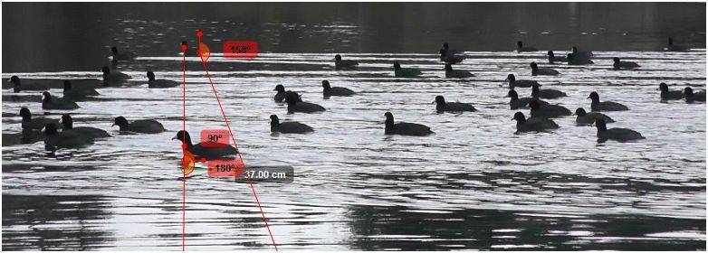

HughT said:
have computed the distance between them to be 392cm. Does this sound correct?
It isn't clear to me how you computed the distance. Are are referring to the distance between them in 3 dimensional space? Did you estimate the range to each bird, and the angle between them and use geometry to calculate the distance? Or are you referring to distance in some 2 dimensional space, as if the image were a photographic print?
He figured that, if one bird appears scaled down to 1/37th its size, and the other to 1/74th, then he could imagine both scaled down to 1/56th ((37+74)/2 = 55.5), and then the apparent 7 cm. distance between them would be 7x56 = 392 in reality. The problem is that, even if everything is on the same plane to begin with, the red line in the figure below can be much shorter than the green line (<lie>and, the more zoom he's using, the narrower the field-of-view angle and the more error you will incur on</lie> not really; the lines were meant as toward objects in the world, and have nothing to do with field of view or the photo's properties. Sorry for the brainflop.).

I think a simple idea would be to use two coots which are horizontally at the same level in the photo, and that have the same size (so they are at the same distance from you). Then you can use your proportionality method (and be able you justify it yourself in your paper) to estimate the distance between the two birds. But estimating distances in the back-to-forth axis, that will not be that simple.
Another recommendation I would do is to make the measurements on the photo in 'pixels' (any paint program should be able to tell you pixel coordinates as you move or click the mouse). All units on the photo must be the same (f.i. pixels), and then all units in the real world must be the same (for example, centimeters); but there is no need for the units in both photo and world to be the same. And measuring in pixels on the photo will give you far more accuracy than trying to use a ruler on such small distances in the photo.

What you need is some object in the picture which is a known distance from the camera. What you get from the dimensions of two birds B1 and B2 is an estimate of the ratios their distances D1 and D2 from the camera. B1/D1 = B2/D2. You don't have enough information to find D1 and D2 or D2 - D1.
By the way, one of such possible objects is the image sensor itself - which is why focal distance (which we don't have) and sensor size (which we can guess) are important.
