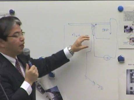

http://www3.nhk.or.jp/news/genpatsu-fukushima/20120201/index.html An 8.5 ton leak was found on unit 4's first floor at 10:30 PM on 31 January. A ⌀ 9mm pipe connected to the reactor was pulled out of a junction part. The radiation of the water is 35.5 Bq/cm³ . The leak was stopped by closing a valve on the reactor side. The water went no further than the reactor building basement. Tepco said "we are unsure if this was caused by frost".
http://www.tepco.co.jp/en/nu/fukushima-np/images/handouts_120201_01-e.pdf "Status of Water Leakage on the 1st floor of Unit 4 Reactor Building, Fukushima Daiichi Nuclear Power Station (Test line of the Piping for Jet Pump Measurement)"
http://www.47news.jp/CN/201202/CN2012020101002248.html It is thought that the water started leaking at around 5 PM on 30 January. Tepco earlier reported a 6 liter leak, but after checking, announced the quantity was 8.5 tons. The 8.5 ton quantity is inferred from the water level drop in the tank installed on the side of the fuel pool. It is thought that the water expanded by freezing, creating an internal pressure pushing the pipe away.
In the afternoon press conference, Junichi Matsumoto makes a small drawing on the white board and explains to a journalist that the fuel pool's water level remained stable, even though the skimmer surge tank's water level decreased on 30 January by 60 to 90 mm/hour (instead of the usual 3 mm/hour caused by evaporation). Tepco started patrolling the plant to find the leak at 22:00 on 31 January. Junichi Matsumoto agrees with a journalist that this was late, but as the airfin cooler had been adjusted, the operators thought that the water level drop could have resulted of a drop of temperature, and hoped for about 24 hours that the water level would stabilize. When the leak was stopped, the skimmer surge tank water level had dropped by 1.10 m (1 February afternoon press conference video at http://www.tepco.co.jp/tepconews/library/movie-01j.html )
http://www.tepco.co.jp/en/nu/fukushima-np/f1/images/intake_canal_120201-e.pdf page 3 "There was no Pu-238, Pu-239 and Pu-240 detected from the sample for this analysis" [north water intake canal Units 1-4 Fukushima Daiichi Nuclear Power Station, 16 January]

tsutsuji said:
http://www.jiji.com/jc/c?g=soc_30&k=2012020300467 On 3 February, Tepco said that the water level in unit 4's skimmer surge tank was decreasing at twice the usual pace and that there is a high probability that the water is leaking. Tepco is urgently looking for the location of the leak.
The above is dated 2012/02/03-12:54 so it is probably from the morning press conference. I watched the 3 February afternoon press conference video ( http://www.tepco.co.jp/tepconews/library/movie-01j.html ), where Junichi Matsumoto said that after refilling the skimmer surge tank, the dropping rate was around 10 mm/hour which is within the allowed range, taking evaporation into consideration.
I checked the skimmer surge tank water level data at
http://www.tepco.co.jp/en/nu/fukushima-np/f1/images/12020406_table_summary-e.pdf
http://www.tepco.co.jp/en/nu/fukushima-np/f1/images/12020312_table_summary-e.pdf
http://www.tepco.co.jp/en/nu/fukushima-np/f1/images/12011712_table_summary-e.pdf
http://www.tepco.co.jp/en/nu/fukushima-np/f1/images/12011812_table_summary-e.pdf
2997mm on 4 February 05:00
3179mm on 3 February 11:00
(3179-2997)/(24+5-11)=10.1 mm/hour
2318mm on 18 January 11:00
2388mm on 17 January 11:00
(2388-2318)/24 = 2.92 mm/hour
I don't understand why they refilled so little on 3 February (to perhaps between 3000 and 4000 mm, instead of refilling to more than 5000 mm)
In the 4 February afternoon press conference video ( http://www.tepco.co.jp/tepconews/library/movie-01j.html ), Tetsuya Terasawa says that they measured 4 mm between 6:28 and 6:53 in the morning which he calls "a stable 4 mm". He says they reached the conclusion that the variation of skimmer surge tank water level is explained by causes such as evaporation and the volume variation caused by temperature, and is not caused by a leak. The NHK journalist asked if it is 4 mm "per hour", and Terasawa said "yes" (until the NHK journalist asked, I thought it was 4 mm in the 25 minutes from 6:28 to 6:53). He also said that there was a 12 mm/hour drop at 11:00 on 3 February. Tepco has no plan to further investigate the causes of the water level drop, but will carefully survey the skimmer surge tank water level.
http://www.asahi.com/national/jiji/JJT201202040074.html [4 February 22:06] Tepco was studying the possibility of a leak as unit 4's skimmer surge tank water level was decreasing at twice the usual pace on 1 and 2 February, but after refilling the tank, the decrease rate became smaller. Tepco explains the temporarily quick pace with the reduction of volume due to the temperature fall and to the evaporation increase due to dry air.
