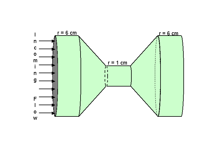

A tube of radius 6.000 cm is connected to tube of radius 1.000 cm as shown above. (see attachment)..
Water is forced through the tube at a rate of 20.97 liters/min. The pressure in the 6 cm tube is 1.015×105 Pa. The density of water is 1000 kg/m3. Assume that the water is nonviscous and incompressible, and keep at least four digits in your computations.
(a) What is the velocity of the water in the 6 cm radius tube?
this is easy but i keep getting wrong answer --dont know why?
heres what i did
Im = v * A (that is, flow rate = velocvity times area)
so after conversions (20.97l/m /60 * 10^-3 = m^3) i have
Im = 3.495*10^-4m/s * .011 (pie*.06^2)
= 3.845*10^-6m/s
this is wrong.
Why?
please help... thanks!

well i didnt put brackets in right place.
should be
(20.97l/m /60) * 10^-3 = m^3)
=3.495*10^-4
still doesn't solve prob though.
any other help?? please help!??
Hence velocity = flow rate/area
