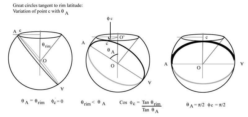

For case 3a the Ant in the northern hemisphere I think I understand. The shortest route always passes through the P(∏/2) point on the rim. If we imagine the initial ant position as the pole of a sphere radiating 'longitude lines' (all the great circles from A) we are only interested in those that hit the rim since the ant must cross it somewhere between 0 ≤ ø ≤∏/2 . Of these possible routes the one with the longest path along the great circle to the rim will be optimum because it will minimize the walk along the rim. So we are looking for the great circle from A that just touches the circle of the rim tangentially. This will define the point of intersection of these two circles
C(ΘA) on the rim. This is where the ant leaves a great circle starts to walk along the constant latitude of the rim to P(∏/2). The symmetry of the problem then gives the length as just 2 times the A to C to P distance as the shortest A to H distance.
The position of C around the rim, øc , depends on the angle ΘA of the initial ant's position with respect to the vertical. If ΘA= Θrim the ant and honey starts on the rim and C is obviously at ø=0 and the shortest distance is just the rim ∏RSinΘrim. If the ant starts at ΘA= ∏/2 it is on the equator of the bowl and C has moved around to ø=∏/2 and the AH shortest distance is just ∏R.In general we need to find point C if we are to calculate the actual distance of the shortest route for a particular ant position ΘA. This is a tricky bit of coordinate geometry!

The general solution for the shortest path from A to H case 3 is a path A-C-P-C'-H via point P(∏/2) on the rim as discussed above. The critical point C where the great circle from A just touches the rim tangentially occurs at an angle ψc around the great circle from A and at an angle øc around the rim from A determined by the latitude of the rim,(set by Θrim) and the latitude of the ant (set by ΘA both measured from the vertical). It is an exercise in vector analysis to show that the tangent point occurs at:
Cos ψc= Cos ΘA/ Cos Θrim
Cos øc = Tan Θrim / Tan ΘA
∴ For ant positions Θrim< ΘA <∏/2

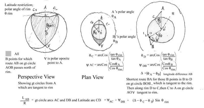

nixed said:
What then is the shortest path between any two points A and B on a sphere, if the shorter arc of the great circle connecting them is interrupted by a restriction that we cannot go above a certain latitude?
The insight from Case 3a above may suggest the answer.
Consider the attached diagram
If point B is on the sphere surface outside the shaded spherical triangle, then the shortest route B to A is the shorter arc of the the great circle passing through A and B. (N.B. there is always one and only one such great circle for a given A and B unless they are polar opposites, collinear with the sphere center O, in which case there are an infinite number). For B outside the shaded region, the great curve connecting A and B never goes further north than the rim so the latitude constraint does not act.
If B is in the shaded triangle the shorter arc of the great circle B to A goes north of the rim latitude. What is the shortest route in these cases?
There is no other great circle route direct from A to B (uniqueness of the great circle). The best we can do is to travel on two different great circles (in planes BOI and AOI say) which intersect at some intermediate point I on the sphere surface. We travel along arc B to I and then I to A. To minimize the distance B to A we must orient the plane BOI with respect to AOI so the intersection point moves as far north as possible without leaving the sphere surface or going above the latitude of the rim. To see this, imagine a different great circle plane BOI’ such that I’ is further north than I. Point I’ can then be arrived at from B either by B to I on great circle BOI then I to I’ on great circle AOI or directly from B to I’ on a single great circle BOI’. The latter is always shorter. The best orientation of the great circle from B is that which just touches the rim latitude tangentially so defining a point of intersection with the rim, D, the same way C was obtained from point A).
Referring to the plan diagram, the arc BD along this great circle is shorter than B to t1 then t1 to D for all t1 on the rim latitude arc B’toD (uniqueness of great circle between two points again). You might wonder why choosing a great circle route B to t2 doesn’t reduce the distance to A still further. This is because any great circle route from B which hits the rim beyond D has already risen above the plane of the rim and has intersected it already at some point t1 between B’ and D so actually lengthening the path.
So the optimum route from B to A is the great circle arc BD then the latitude line DC then the great circle arc CA. We can write an expression for the length of this route in terms of the polar and azimuthal angles which define the A and B positions. See diagram.
This has obvious applications for optimum aircraft routes between cities if the planes cannot fly higher latitudes over the poles.

Given two points A(θAA) and B(ΘBB) and a latitude restriction Θrim how do we tell if the great circle between A and B will rise to higher latitudes than Θrim?
The parametric form of the great circle passing through two points was derived in the post "great circle problem". The z(ψ)/R coordinate is
Z(ψ)/R = Ca Cos ψ + α Sin ψ
where 0≤ψ≤ 2∏
α = { Sa2Cb - CΔCaSaSb} / Sinδ
δ = arcos(CΔSaSb + CaCb}
where Δ= øb - øa the longitude difference of A and B
Ca = CosΘA ; Sb = Sinθb etc
the maximum value of this occurs when d [z(ψ)/R]/dψ =0 ∴ tanψm = α/Ca
as Cosψ = 1/√(tan2ψ +1) and Sinψ = tanψ/√(tan2ψ +1)
Z(ψm)/R = √(α2 + C2a). If this is larger than cosθrim then the great circle tracks north of the latitude restriction and the formula for L/R under constraint must be used. If
√(α2 + C2a) < cosθrim
then the shortest distance between A and B is the great circle arc length
LAB /R = δ

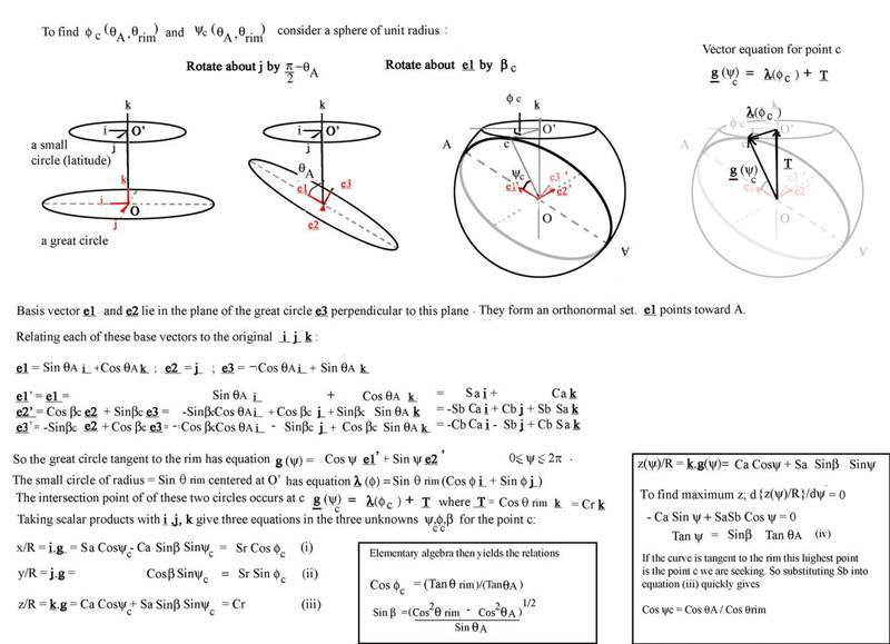

The analysis is shown in the attached sheet for those interested in following the details.

Here is another helpful picture of great circles tangent to a given latitude
