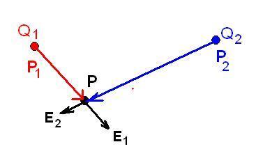

I thought of this problem.
[PLAIN]http://img94.imageshack.us/img94/2664/33685990.jpg
Where Q1 = Q2 and Q1 is at (0, 10) and Q2 is at (10,10). from symmetry it must be where (5,10), but the math gives me (5,y)
Q1/(10-y)² = Q2/(10-y)²
Clearly, y can be anything, what does that mean?

  • #67
Q1/(x)² = Q2/(10-x)²
The y coodinate is y=10 for all points including the one where E = 0.
I wouldn't do it in polar coordinates - too messy.

  • #69
The method we are using only works for two charges on a line, with the E=0 point on the same line. In this last question, everything is on the line y = 10.
It would be interesting to try doing a question where the two charges are not on a horizontal or vertical line. The easiest approach would be to draw a straight line joining q1 and q2 and using their separation distance - essentially rotating the coordinate system so only one dimension matters. Otherwise, the equation would have both x's and y's. A second equation - requiring the null point to be on the line joining q1 and q2 - would be needed to solve for both the x and y coordinates of the null point.
  • #70
That's what I thought because
Will never work.
