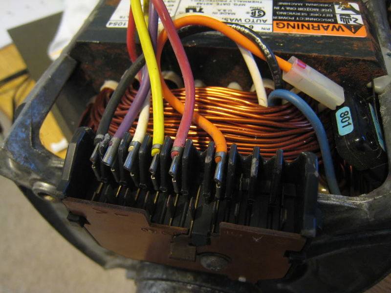

Wife recently talked me into one of those newfangled washing machines with three phase computer driven motor and every automatic function conceivable. But i hung onto the old Sears with induction motor and mechanical timer for when the hightech gadgets give up the ghost.
Induction motor for home appliances looks to be on its way out. Handymen better stash away a few for workshop fixtures .

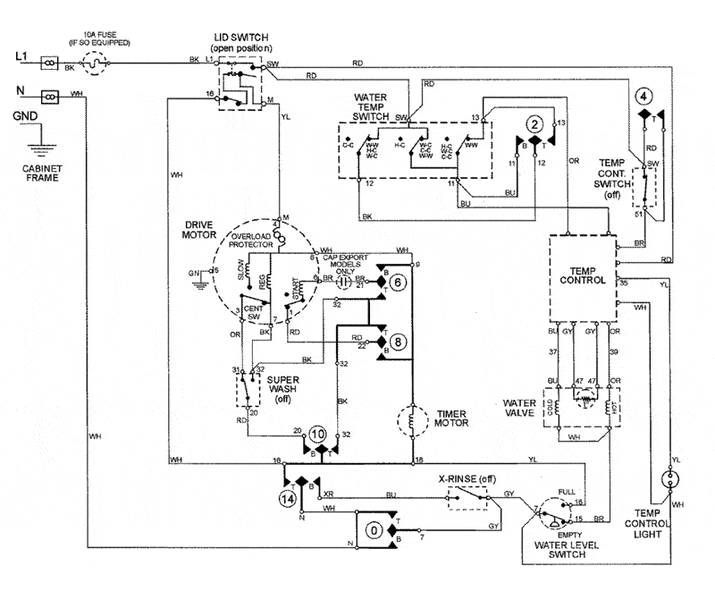

typical washing machine, courtesy of somebody on Photobucket:
on this one you'd tie red to black or orange, whichever one you tied red to above,(1 to 7 or 3) depending on speed you want
and brown to white (6 to 8) so it'll start
then apply power from M to orange or black(what color is M? term 4 to 3 or 7) and you'd have a motor for that shop fan or grinder.
While color and numbering is not same on all manufcturers, the circle in above drawing is typical arrangement of almost all washer motors. The terminals are on the centrifugal switch.
so with an ohm-meter you can figure out what colors and terminal numbers they used.
sorry for off-topic. old jim

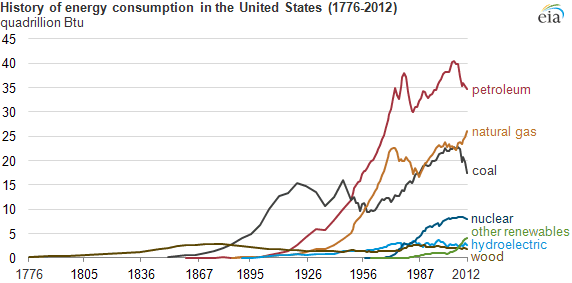

That may be hard. Think about how much energy one quadrillion BTU is. It's going to take a hell of a lot of wind generators. That the real issue IMO.
http://www.eia.gov/totalenergy/
