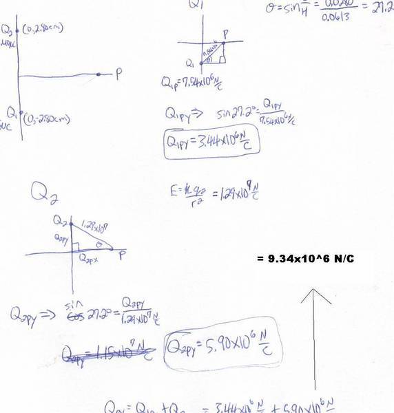

Two charges, Q1 = 3.15 μC and Q2 = 5.40 μC, are located at points (0, -2.80 cm) and (0, +2.80 cm), What is the magnitude of the electric field at point P, located at (5.45 cm, 0), due to Q1 alone?

Ok so there were two other parts to the question, I had to find the xcomponent and ycomponent of total electric field at P. I solved the one for x and got it correct which means I must be using the right angle and stuff to do my calculations. My answer for y was wrong, why is this?

Beats me. Show what you did.
Workings are on attached file...

Check your signs. Realize that one field points up, while the other points down.
opps so there should be subtraction to get my final answer...
So the Q1 diagram needs to be a negative answer...
(-3.44x10^6)+ (5.90x10^6)
=2.46x10^6N/C

Q1 is the one on the bottom, right? So where does its field point?
Ok, so the Q1 line points in the positive direction while the Q2 points in the negative direction right? I got the right answer but I just want to make sure my reasoning for sign convention is understood.
Right. The field from a positive charge always points away from the charge. So the y-component of the Q1 field is + and the Q2 field is -.
