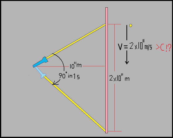

Suppose you have a source that send a very strong straight beam of light (say laser )
Then you direct the light toward a distant wall with angle 45 degree
as show in the drawing below
Then if you rotate the source 90 degree in one second, what is the velocity of the visual effect (spot)on the wall?
According to the distances given in the drawing it must be greater than the spead of light !
I do not know if anyone think of this before but I hope I will receive more comments and analysis about this simple case.
How does someone standing at the top of the screen use that spot to send a signal to someone standing at the bottom of the screen? :smile:

He can use another spot signal to the person who hold the torch.
and the total velocity of the signal from the top to the bottom will be still greater than C
Why not just shine the light at both places at once?
The spots that the light shows hold no information about that point. It's just light sent from the laser to that specific point. If you want some information from that point it has to send a signal back.
Sure that point might look solid to you but it's just light being sent from the light source. Or think of you light source as a machine gun and the light as a bullet. Sure it might look like you drew a line on the wall but it's just a bunch of bullets.

It might only take 1 second to turn your source from pointing at the top to pointing at the bottom. But once you point the source at the bottom the signal still needs to move from the source to the bottom. Just because you point the source at the bottom doesn't mean it instantly get's the message.

If person (A) at the top of the screen wants to use that torch to signal to a person (B) at the bottom, he must:
(1) Send a light signal to the torch holder (at T)
(2) Have the torch holder shine the light towards the second person (at B)
So the signal must travel a distance of A to T, then T to B. He'd be much better off shining his own light directly at B! (If the torch holder wastes time sweeping the light from A to B, it will take even longer for A to signal B.)
If the torch is simply swept from A to B, the apparent speed of the spot may well be greater than c but it is useless for signalling from A to B.
(Edit: I see that darkhorror made the same point. :rolleyes:)

yes you are right ... my mistake is that i thought ( absent-minded) that the ray of light will conduct like a solid stick
but by the way what if we use a solid stick instead of the light ray ?
Then the stick will bend.
