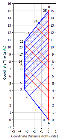

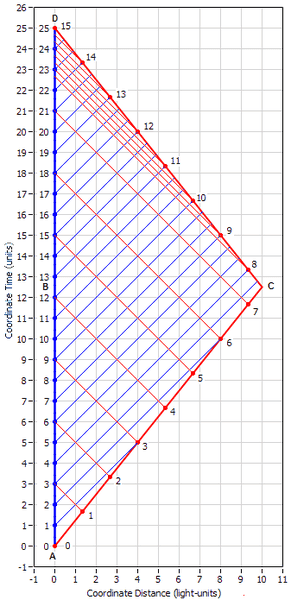

  • #117
GregAshmore said:
I would like to see a SR solution which has me in one position throughout the episode.
How about this one:
from this thread.
  • #118
ghwellsjr said:
How about this one:
from this thread.

I decided that I ought to do the calculations that I should have done Friday night, before reading any of the posts or papers referenced since then. Here's my best shot at the Twin Paradox. Later this evening, or maybe tomorrow night, I'll see how what I did compares with your suggestions.
I can't say that I did this without any outside influences since Friday night. I did see that the image that George referenced looks like a spacetime diagram. That may have triggered some thoughts about coordinates.
I do all the calculations for the spacetime diagram but did not include an image of it. You all know what it looks like.
Solution of the Twin Paradox - to the degree possible knowing only the Lorentz transform and the usage of the spacetime diagram.

Calculate the coordinates of Event D.
Time for approach is same as time for separation. (Relative velocity is the same.)
Xde = 0.0
Tde = Tbe + Tbe = 25.0
Xdrp = g((Xde - Xce) - V(Tde - Tce)) + Xcrp
Xdrp = 1.667((0.0 - 10.0) - (-0.8)(25.0 - 12.5)) + 0.0
Xdrp = 1.667(-10.0 - (-10.0)) + 0.0
Xdrp = 0.0 (Confirms inertial behavior of rocket from Event C to Event D: Xcrp = 0.0)
Tdrp = g((Tde - Tce) - V(Xde - Xce)) + Tcrp
Tdrp = 1.667((25.0 - 12.5) - (-0.8)(0.0 - 10.0)) + 7.5
Tdrp = 1.667(12.5 - (-0.8)(-10.0)) + 7.5
Tdrp = 1.667(12.5 - 8.0) + 7.5
Tdrp = 7.5 + 7.5
Tdrp = 15.0 (Confirms approach time equals separation time in rocket frame.)
Answers to questions:
Q1. Both the Earth and the rocket claim to be at rest throughout the episode. Can both make good on this claim?
Yes, kinematically. Earth and rocket X coordinates are 0.0 throughout.
Whether this makes physical sense dynamically is unknown, given limited knowledge noted above.
Q2. What are the clock readings on Earth and rocket at G6?
The Earth clock reads 25.0.
The rocket clock reads 15.0.
Q3. Are the clock readings calculated for Q2 unambiguously unique?
Yes. There is only one way to construct the spacetime diagram, due to the unique non-inertial behavior of the rocket.
Visually, the Earth and rocket experiences are symmetric. Each sees the other move away and return. Nevertheless, the rocket is unambiguously younger than the Earth at reunion.
