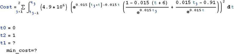

i want to find the minimum sum of this equation and find the t like using solver in Excel,but since the integration cannot be integrate directly,i didnt know how to use the numerical integration to apply for this problem.
i want to find the value :let say when n=2, t_0=0 and t_n=1, so i need to find t_1 that will make the equation become minimum value.I hope that anyone can help me.
Sum[Integrate[4.9*^6*E^(-0.03*t + 0.03*(t + Subscript[t, j]))*
((1 - 0.015*(6 + t))/E^(0.015*Subscript[t, j]) +
(-0.91 + 0.015*Subscript[t, j])/E^(0.015*t))^2,
{t, Subscript[t, -1 + j], Subscript[t, j]}], {j, 1, n}]
write the equation you want to solve in normal way (like what written in your book) so i can help
i had attached the equation.how can we use numerical integration in mathematica to solve the problem?or any other method can be used?
Let us try to solve it step by step
first I'll open the sum and get the following equation
http://www.3mints.info/upload/uploads/bbb65e0e17.jpg
and x is t1
press enter and get this answer
http://www.3mints.info/upload/uploads/f53bc6e9d8.jpg
now to find minimum you can take derivative and make it equal zero but i faced problem when trying solve function to zero i got the following massege
olve::tdep: The equations appear to involve the variables to be \
solved for in an essentially non-algebraic way
so i have to find another way . I plot the function to see the shape
http://www.3mints.info/upload/uploads/65a285154e.jpg
as you notice the minimum value of x is around 0.5 corresponding to arround 1 as a value for cos t.
I evaluated the function x at numbers between 0.4 to 0.6 with 0.00002 step and found that cos t = 0.894953
see figure
http://www.3mints.info/upload/uploads/116575a4af.jpg
and by iteration you can find value of x
x = 0.51219
please this is not for sure the right answer but it could give an idea
