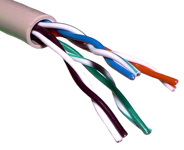

I saw "Oresund Bridge - Megastructures" in national geographic, and that bridge is made out of wires bundled next to each other, rather than twisted wires. I wonder, since twisted wires are stronger, what is the advantage of wires bundled next to each other?
If you are asking about twisted insulated wires like these:
Noise sources introduce signals into the wires by coupling of electric or magnetic fields and tend to couple to both wires equally. The noise thus produces a common-mode signal which is canceled at the receiver when the difference signal is taken.
http://en.wikipedia.org/wiki/Twisted_pair"
