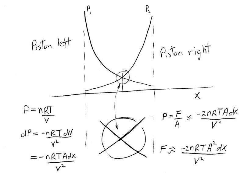

Picture. The volume of that cylinder is V = 1l. In that cylinder we have 1g of hydrogen m=0,001 kg. The cylinder is separated in two equal parts with m1=0,005 kg and d=0.006m length piston. Imagine that we pushed that cylinder and piston in there began to swing. We need to calculate swings period dependence on temperature of the gases.
We need to find k in this formula. F= -k x ( it's the force, which trying to return piston back to his place) And place it in this formula T = 2 Pi sqrt(m1/k)
In my opinion that F is the difference of pressures in that cylinder.
I would calculate both pressures with this formula:
p V = m/M R T
and then I would deprive.
F would be : F = (delta)p S
But when I calculate, my V and m depends on the x, and he disappears.
In my head there are no more thoughts, so I'm asking you for help.

Below I keep temperature constant, for small displacements I think that is OK. Hope the following helps.
For more accuracy you may want to expand V^2 = [V_o + dV]^2 about V_o ?

On my sketch I wrote
F = [-nRTA^2dx]/v^2
let dx = x
F = [-nRTA^2x]/v^2
This is of the form,
F = kx
which you should know from the harmonic oscillator. Now F is a function of several numbers, one of them is T (all but x are roughly constant for small displacements x). The corrections go as x^2?The problem gets harder if we need to be more accurate. I don't know how far you need to go.
Good luck!

Assume the cylinder is insulated and that the compressions and expansions are adiabatic. You have to use the adiabatic condition PV^γ = K in order to solve this. You cannot just assume that the restoring force is linear.

I'm confused then. If my sketch of the pressure verses position of the cylinder above is close then for small displacements the sum of the two pressures will be some linear function of x (for small x)? For small displacements F = kx.
I not too sure about my value for k though.

I am saying that the restoring force is not linear. It is proportional to -x^γ
Since the initial volumes are the same (say, V) and the pressures and temperatures are initially the same in the equilibrium position, and since the total volume is always the same:
P1(V-dV)^γ = P2(V+dV)^γ = K
Since the net pressure on the piston is the difference between the two pressures:
P1-P2 = F/A = K/(V-dV)^γ - K/(V+dV)^γ = K/(V-Ax)^γ - K/(V+Ax)^γ
Letting A be the cross-sectional area of the cylinder and L the length of the space on each side at equilibrium the net force is:
[itex]F = K(A/(AL-Ax)^γ - A/(AL+Ax)^γ) = KA^{(1-γ)}(1/(L-x) - 1/(L+x))^γ[/itex]
For x << L, (1/(L-x) - 1/(L+x))^γ ≈ -(2x/L^2)^γ
So it seems to me that:
[tex]F = - KA^{(1-\gamma)}\left(\frac{2}{L^{2}}\right)^\gamma x^\gamma = -kx^\gamma [/tex]
where [itex]k = KA^{(1-\gamma)}\left(\frac{2}{L^{2}}\right)^\gamma[/itex]

From my earlier post:
[itex]F = -kx^\gamma [/itex]
where [itex]k = KA^{(1-\gamma)}\left(\frac{2}{L^{2}}\right)^\gamma[/itex] and [itex]K = PV^\gamma[/itex] where P and V are the pressure and volume at any time eg. P0 and V0, the initial pressure and volume.
To find the relationship to temperature you would have to express the adiabatic condition in terms of T0, the initial temperature and V0, the initial volume. You do this by substituting for P0: P = nRT/V
[itex]K = P_0V_0^\gamma = nRT_0V_0^{\gamma -1}[/itex]
So the force equation becomes:
[itex]F = -nRT_0V_0^{(\gamma -1)}A^{(1-\gamma)}\left(\frac{2}{L^{2}}\right)^\gamma x^\gamma[/itex]
Since [itex]A^{(1-\gamma)} = A^{-(\gamma-1)}[/itex] we can reduce this to:
[itex]F = -nRT_0\left(\frac{V_0}{A}\right)^{(\gamma -1)}\left(\frac{2}{L^{2}}\right)^\gamma x^\gamma[/itex]
But V0/A is just the length of the chamber on each side of the piston, ie. L.
So this reduces nicely to:
[itex]F = -2^\gamma nRT_0L^{(\gamma -1)}L^{-2\gamma} x^\gamma = -2^\gamma nRT_0L^{-(\gamma + 1)}x^\gamma[/itex]
