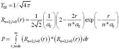

The spherical harmonics are normalised so you don't need to take accont for them when you do the integration.
I use these equations:
a_0 is the Bohr radius, 0.5291 Å
I get r,node = 1,057 bohr radius
Probability to be outside the node = 0,064
I used a Texas Ti-83 for this (and one year old quantum mechanics knowledge:rolleyes: )

Haven't you calculated the <r^2> ?
Are those commas on accident, o is that supposed to be periods? Because 559 Angstroms is way to much and if that's a 64, a probability has be between 0 and 1. So what I've done since i posted this is I've fixed all my units, i had forgotten to break down the Joules term, I got a node at radius .066 Angstrum and the same probability. Also your Y term is missing the Legendre Polynomial (the Theta term).
As for calculating r^2 and integrating using Phi and Theta, its part of the radial distribution function to distribute the probability around a sphere instead of just a singe direction. But i get the same probability doing it ur way as well, so i see how they are normalized.
