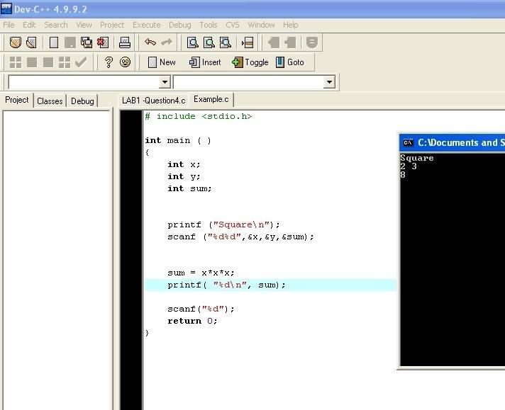

I am trying to write a program on a C compiler and I am not too sure how to do it.
The question asks to write a full program to calculate the squares and cubes of the numbers from 0 to 10, which uses tabs (\t) to illustrate the data in the table.
Click on the uploaded document to view the question.
"Ques Example.jpg"
Also I have given an example of a square root I have calculated for a number in
document,
"Example of.jpg"
However I am not too sure which instructions are needed to show the information in a table.
Please help, thanks very much !

You have to compute the square and cube of a number. You already computed the cube. Print the data using printf, one line at a time. If formatted correctly you will get the desired pretty table. You already used "\n" to generate an end of line. Tab is just another special character: "\t" instead of "\n".

Looping in 'c' is done with the for or while statement.

Um... I have only really mannaged to separate the three columns. But when I type in the numbers it won't show properly, as I am missing out a large part of the program.
Can you post your code? You can post your code on rafb.net/paste - you will be provided with a link - please paste that here.
Also remember to make sure "C" formatting is on when you're on that website.
Yes I have it here now.
It automaticaly calculates the square and cube roots of the first number typed in.
However the first number you type appears in the table as well and will not let me type in more numbers for the next line.
A loop in the program is needed here ?
http://rafb.net/p/CBphkL43.html
yes a loop is needed here.
EDIT sorry I thought you didnt want to input numbers to appear for some reason.
Pay attention to the carriage return that will make your table look bad after scanf.

++ is to increment variable idx so after it deals with one number say 3 in the loop and adds it to the table, it will move to 4 and so on.
idx++ means idx=idx+1. If this was not put then you will get stuck in an infinite loop and have a program crash.
