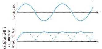

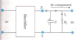

in my textbook, they've said that a capacitor is used to filter an input from a full wave rectifier.. So that the output does not fluctuate (much) and hence convert an a/c current to d/c current. But, the textbook isn't clear about how this happens.
It just says that the time constant for the capacitor needs to be made large, for which the load resistance is increased.
The textbook diagrams are attached below.. pls have a look

It will help you understand what is going on if you draw separately diagrams of the following:
(1) the output voltage from a full wave rectifier alone, given an AC input voltage (2) the output voltage from an RC circuit (capacitor and load resistor in parallel, i.e. a filter stage as you've indicated in your diagram), given a DC input voltage.
If you're looking for an intuitive picture, you can use the model where the capacitor acts like a spring. When it is not charged, it is effectively a short circuit, so the current will flow there most easily. Once it gets charged, it "pushes" back, which coincides with the output voltage from the rectifier sagging (with an appropriate choice of capacitance). In other words, the capacitor stores enough charge to "fill in" the troughs in the output current.
Another way to think of it (which only just occurred to me) is with the good ol' water analogy. If you have a current of water that it pulsing, you could run it through a tall reservoir with an outlet at the bottom. The pressure from the water in the reservoir will compensate for the sags in the input current, giving you a smoother output flow.

The time constant has to be large wrt the period of the input waveform. You can have a simple viewpoint whereby the cap discharges through the load when the output of the rectifier is around zero volts. The cap will then act as a source to the load and will discharge through it. If we however make the time constant very small, then chances are that the cap will discharge significantly through the load causing unwanted ripples in the output. Therefore, the larger the time constant, the longer the cap will take to discharge and the output ripple will be reduced.
