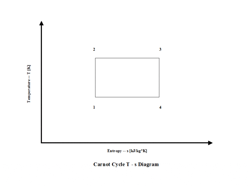

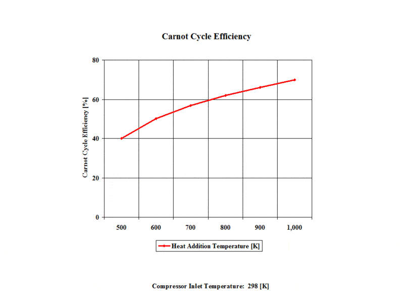

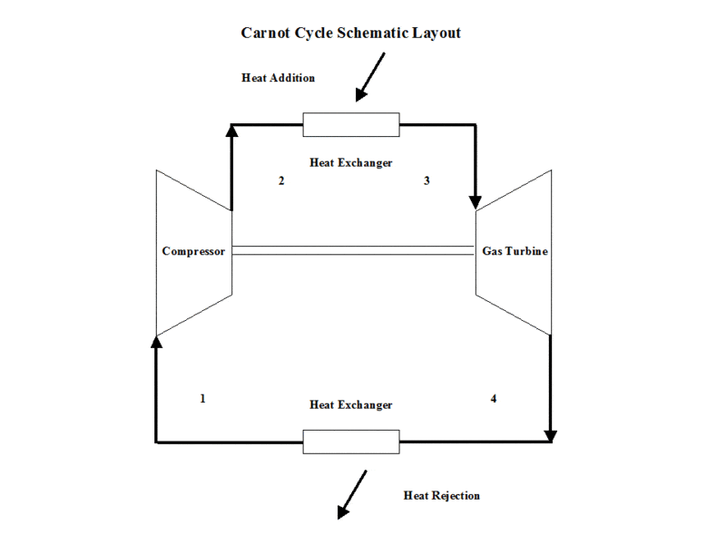

Hi there:
Here are a few plots regarding the Carnot Cycle operation and usefulness.
Thanks,
Gordan
