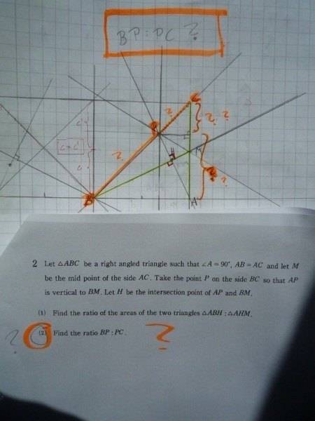

Let ABC be a right angled triangle such that A=90, AB=AC and let M be the mid point of the side AC. Take the point P on the side BC so that AP is vertical to BM. Let H be the intersection of AP ad BM.
Find the ratio BP : PC.
AB=AC
AM = MC
BP : PC = ?
See the problem here: http://4.bp.blogspot.com/_Qc1Z3hIcYO4/SgbXNoa555I/AAAAAAAABPM/ruupwSz5EoE/s1600-h/bp_pc.JPG.

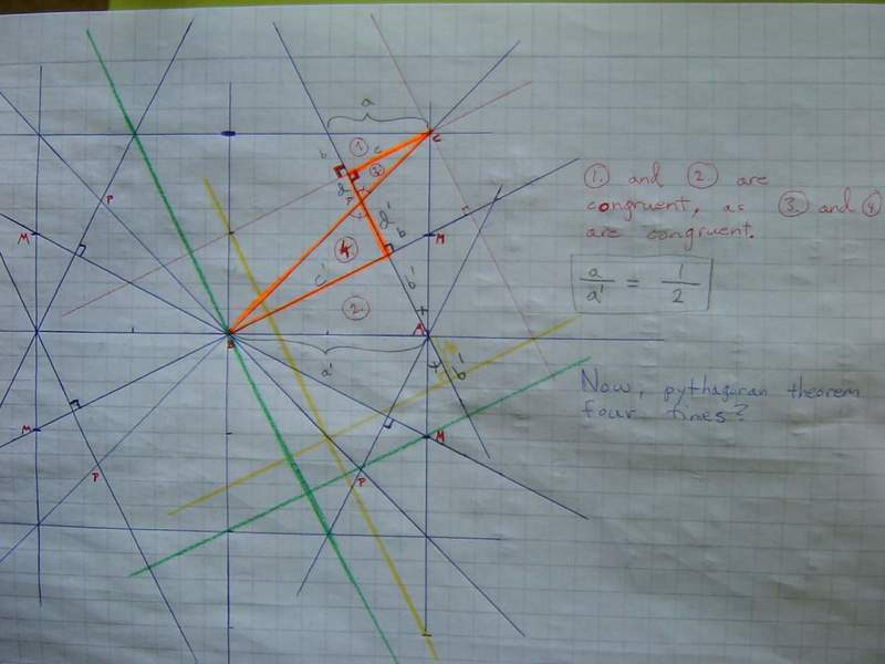

I drew parallel lines, and I found some interesting connections. I am very close to the answer, but I still cannot find it.
Please, see the attachment "parallel_lines.jpg".

Mass points kill this problem in about 2 seconds. Assign mass 2 to points C and A, so point M has mass 4. Using the fact that BAM ~ BFA ~ AFM, you can find that BF/FM = 4, so point B has mass 1. Thus, BP/CP = [ C ]/[ B ] = 2:1 (where [ ] denotes mass).
If you don't know what mass points are, you should go learn about them immediately. (They're awesome.)
Great thanks for the awesome tip!
