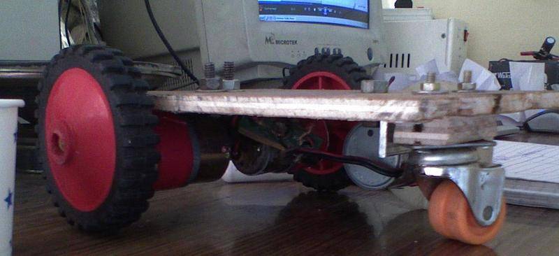

bloshe1
Hello!
Me and my team are working on a two-wheel simple robot having two motors and 12v 1.5amps supply for a small intra-college robo-race.
The wheels are 10cm diam. and we have a cylindrical body between the two wheels with 8cm diam. The setup is all wired, nothing wireless( with the remote ).
We have less time and no money(india), so we went wired. Anyways the problem is, when we turn on the motors, the entire cylindrical body moves but not the wheels. Note that the wheels are little heavier than the main body. We made the cylindrical body out of PVC and other two bowl shaped PVC structures to cover the motors.The axis of the motors is screwed with the wheel.
In short, the torque is not being transferred to the wheels but the motor itself.
Any help would be appreciated.
Thanks!

Anyways, have you heard of caster wheels??
http://img2.tradeget.com/huiqiang5/2Y2AYE951wheel.jpg
And, as Emreth explained, making the body heavier isn't a smart solution.

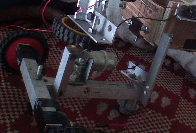

caster wheels looks promising but as i said we are out of money.
Come on dude, it only costs 10 bucks(~0.20 USD). One of the pics has it in place, the other one is a more common Castor, costs even lesser

anyways we are now couple of days away from our final day, we finally attached two small wheels from the middle of the cylinder. That solved our problem, but there is another problem now. We have a 12v limit and we need to climb a gradual 30deg elevation, we tried to do that and the bot stops half-way. We need more torque for that. I am now thinking of getting another motor for the back wheel, which will help climb.
