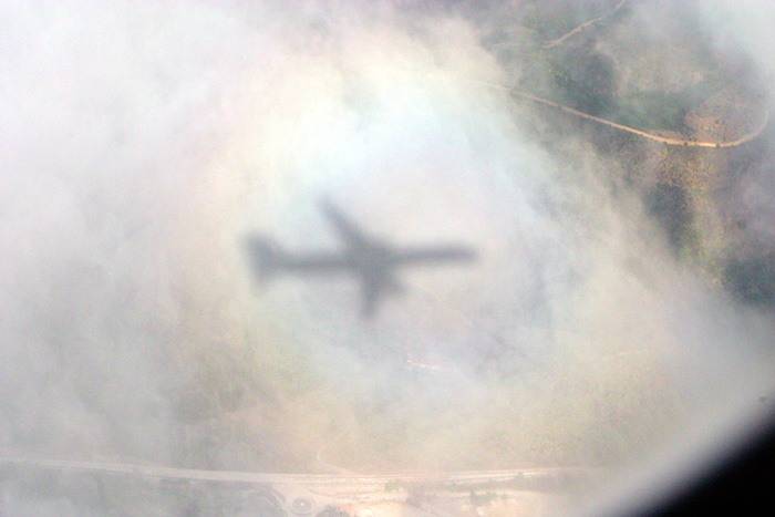

A rainbow's position is always opposite the sun at a particular angle. If you could see the rainbow in its entirety, you would see that it forms a perfect circle around the point exactly opposite the sun from you.
This is a picture of a rainbow as seen from an airplane. Since there's no ground in the way, you can see how the rainbow goes all the way around. Notice the shadow of the airplane where the photographer is taking the pic from. The shadow is dead centre of the rainbow. That's because the sun, the viewer and the centre of the rainbow are all on the same axis.
