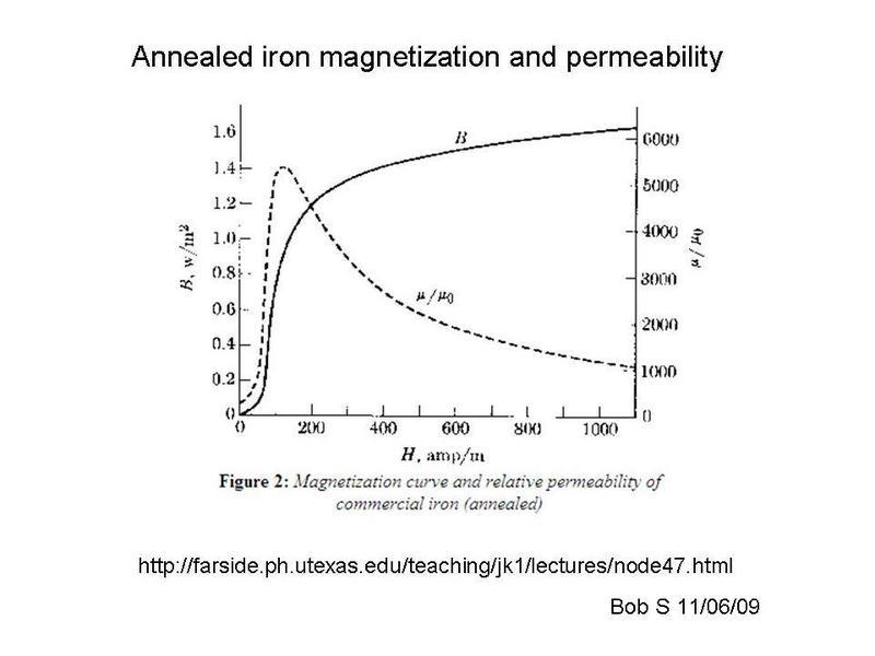

I was trying to get the numbers to design a 1T solenoidal electromagnet with a core of permeability >1000 (electric steel or Permalloy). I think the permeability saturates at some field strength(0.2T?). But I am not sure how to use the formula after saturation. should I just use u0 instead of u0ur?

I am using the formula B=u0ur*n*I
Here in thumbnail is the permeability curve for soft iron. 300 amp-turns per meter should push soft iron above 1 Tesla inside a long solenoid. The equation for the field inside a finite length solenoid is given in Smythe "Static and Dynamic Electricity" 3rd edition page 297.

Bobs, thanks. That makes sense. I just need to grab the static and dynamic electricity book.

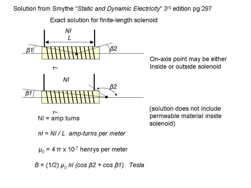

Smythe's exact solution for the on-axis B field in a finite-length solenoid is posted in the thumbnail.

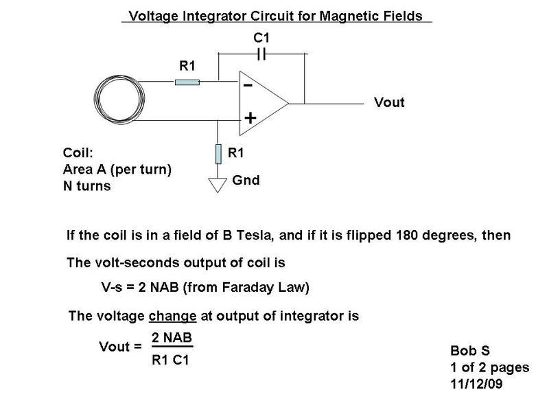

I have used three ways. All are difficult.
1) Integrating coil. Wrap 100-200 turns of #40 wire into a coil with ID the same as the magnet OD. Count # turns. Build an integrating circuit with about 1 minute time constant. R series = 100 k, C feedback= 600 uF. Put a 10 meg bleed resistor in parallel with C. choose a low bias current, low voltage offset op amp.

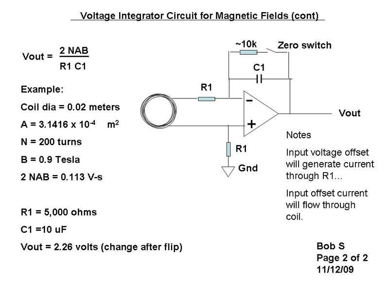

The two attached thumbnail drawings outline a voltage integrator circuit for measuring magnetic fields using the Faraday induction law.
