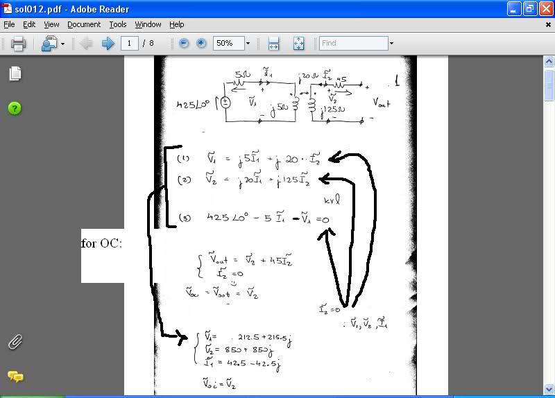

Solving for I1 from Equations 1-3 with I2=0
  • Thread starter Thread starter nhrock3
Setting I2 to zero in equations 1 to 3 allows for the calculation of I1. The first equation simplifies to V1 = j5*I1. Substituting this into the third equation results in 425<0 - (5 + j5)*I1 = 0, leading to the expression I1 = 425/(5 + j5). This value of I1 can then be used to determine V2 by substituting back into the second equation. The process demonstrates how I1 is derived from the initial equations under the specified condition.
nhrock3
403
after we put I2=0 in equations 1 to 3
we have expressions of I1
how did they get I1
because they presented numbers
If you let I2 be zero, then equation 1 becomes:
V1 = j5*I1
Substitute this into equation 3 and you have:
425<0 - 5*I1 - j5*I1 = 0
or
so that I1 = 425/(5 + j5)
Substitute this back into equation 2 (with I2 = 0), and you get V2.
