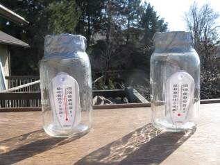

The two glass jars I used

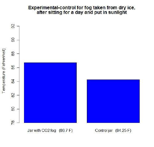

First I decided to use CO2 gas from dry ice. I put some ice in a separate glass of water and let it fog over.
I let the fog catch in the experimental jar. Both the jars were sealed off, let sit overnight to allow CO2 to dissipate, and then temperatures taken during the sunlight the next day. This is what I got. Need some feedback?:

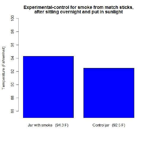

Next I thought it would be interesting to try match stick smoke. I rinsed out both jars and dried them, then held some burning match sticks above the upside down experimental jar. Although more than "CO2 gas" was in the jar, I thought it was appropriate enough of a test since one of the ways among many it gets into the atmosphere is "burning substances". I let both jars sit over night so they could have the chance to be the same temperature. The next day when both of them were in sunlight this is what I got:
Why I thought about testing match stick smoke:

Nice work! Well done. However, I am not at all sure, at this stage, of the reasons for your results. One tricky problem is that glass is also partially opaque to infrared radiation. It may make a difference what your jars are made of. Theoretically, the difference with the CO2 is that it will interact more strongly with the thermal infrared radiation from the surrounds. In some cases this might even have a cooling effect, if the jar is heated mainly by contact with a hot surface, and the gases are able to radiate that heat more effectively. But out in the open as you have done, it makes sense to think that there's extra energy being absorbed from the thermal radiation. But I can't be sure.
Cheers -- sylas

Thanks for the input. Although, I'm not sure why the glass would throw it off, since both jars are made of glass and still there was a difference.
If glass blocked some of the infared, there was still a consistant difference in temperatures between them; I'd try changing the order of what the bottles were and a couple of times. So I'm thinking if there is an issue of internal validity, there'd be something else? (That picture of the jars above shows the sun's rays at different angles, however when I actually recorded the temperatures I made sure it was the same angle for both when I had the control on the right vs. left hand sides)

You make a point. Experiment 2 with the smoke isn't pure CO2; that was mostly meant to test burning substances. However, wouldn't gas from the dry ice be CO2? What percentage of CO2 is dry ice? Since I let it fog over from another container and into the experiment jar, I would think it gave it enough time to be the same air pressure as the other jar, then I sealed it off after letting it sit for 5 seconds. Then considering the smoke jar wasn't much behind in difference from control jar, I'm not so sure that the original temperatures of how I obtained the gases before it was sealed off made much of a difference?

Actually your experiment is quite good, especially considering how simple and intuitive it is.
The visible and UV radiation go through the glass and heat up the interior air and also are absorbed by the material of the thermometers. The heat loss is by IR radiation that doesn't penetrate glass very well, but the variation you are seeing IS likely to be caused by the different gas inside being so opaque to IR at certain wavelengths.
You could also put them in a cardboard box to move them to a quiet cooler room, darkish I should think, and record the rate of cooling of the two containers. That would be even closer to the effect of "greenhouse warming."
CO2 is used as a cooling agent for small temperature chambers, but the tanks available are quite large, probably not practical for your use.
If your source for dry ice is easily available that is about as good as it gets

I agree that dry ice is the best source of CO2 for practical purposes. But the CO2 you get is very high in water from condensation (hence the fog) and water is a far more powerful IR absorber than CO2. If you have no way of drying the CO2, then you could put a few ccs of water in each jar to make sure that they contain the same amount.
It would be good to swap thermometers with each experiment to make sure that they have the same calibration. Commercial domestic thermometers often don't match very well.
If it doesn't stretch your resources, try more jars, to see what degree of variation you get with the SAME treatment. Even better if you could get a nice young lady to help you by labelling the jars A,B,C,D... and not telling you what is in each jar till after the experiment. (Blind experiments reduce bias. With a little ingenuity you can manage a double blind experiment, not telling her what is in each jar, so that it does not matter whether she knows what outcome you want or not.)
You might like to try jars with a few other chemicals in them, such as a few drops of alcohol (meths) or rubbing alcohol (isoprop) etc.

The other thing that would affect this is that the thermal conductivity of CO₂ is 105 mW/(m.K), but the thermal conductivity of N₂ is 24 mW/(m.K) (at one atmosphere and 0°C).
So you would get an underestimate of the greenhouse effect of CO₂, or even the CO₂ cooling faster if you get a situation where heat transfer by conductivity is a similar order of magnitude to that by radiation.

"105?" CRC reformatted and failed to proofread again? CO2 thermal conductivity is a little more than half that of air.
"Overestimate."

Quite right. 14.65 mW/(m.K) and Overestimate.
Thanks for that: I thought that last time I'd had this discussion it had come out the other way, and was thinking that I'd made a mistake then.

Something you may want to consider, I tried the experiment more than once. I switched the places of the jars, some of the times with the control jar on the left, then others on the right, vice versa for the experimental jar.
I actually once rinsed out both jars, dried them, then tried the experiment again in the opposite jar. If the difference between the two jars was the dry ice fog and the smoke, then something in that caused the temperature to be warmer.
The real difference that may not have been the same was two different thermometers. When manufactured they're not completely the same, one thermometer was 1 degree F lower than the other. So to control for that I intentionally used that thermometer for the jar with CO2 so the dry ice fog/smoke would have to work harder. Even after that the CO2 jar had a higher temperature reading despite a manufacturer's calibration of one degree lower than the thermometer used for the control jar.
