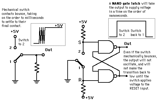

Ive been working on a new project for my studies but can't seem to get any info on 'switch bounce'
It's the electrical noise made by metal coming together to form a circuit. It lasts maybe 40ms depending on the switch.
Google "switch debouncing circuit" and you'll get lots of examples.
If you are interested in cleaning up switch bounce (switch debounce), you can do it with a couple of nand gates.
http://hyperphysics.phy-astr.gsu.edu/hbase/electronic/setreset.html"

Switch Debounce is the process of getting rid of switch bounce. One solution to get rid of switch bounce is given above by dlgoff
