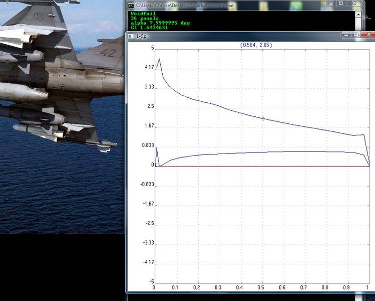

how's this for a NACA4412 airfoil @ 8deg?
Looks quite right imo, still a little funky at the trailing edge though. I just used midpoint aproximation to calculate the lift, not sure how accurate that is.
Now I just need to implement a boundary layer simulation ;P
You are close but I don't think that solution is quite right. The Cl for the NACA 4412 at 8 deg. is approx 1.46 according to xfoil.
What exactly are you plotting there. Its not Cp so I am assuming it is non-dimensionalized velocity. In which case your suction peak is a pretty high. You wouldn't happen to be plotting (V/Vinf)^2 would you? Because if so then it actually might be pretty close.

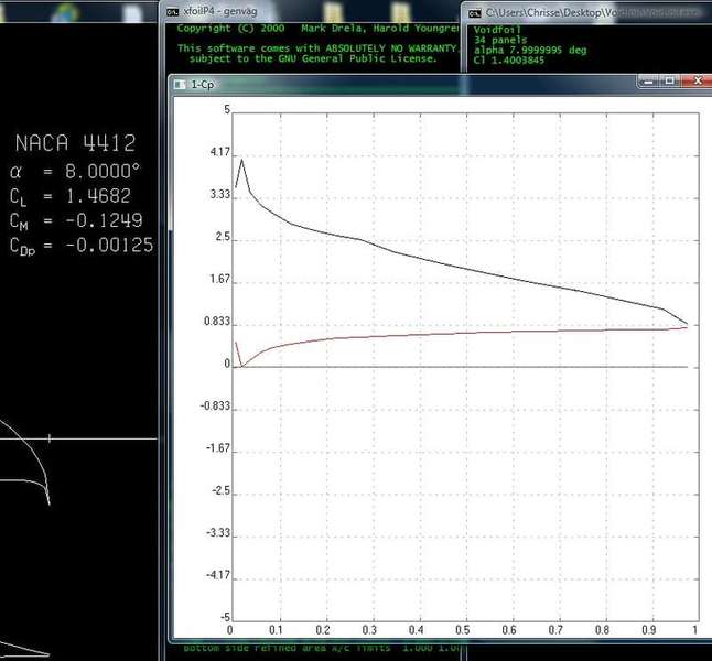

Correct, I'm plotting 1-Cp so it's basicly the same as (V/Vinf)^2. I suspect the difference in Cl is mainly because of the trailing edge panels. by changing them to a more appropiate configuration (similar length) the Cl dropped to 1.4. still not the same as X-foil but if it can change with 0.2 just by changing the trailing edge, I think the solution is correct. As a test NACA0024 was evaluated in Xfoil, the predicted Cl and Cp was in excellent agreement with my own program!
This is what I have at the moment
NACA4412@8deg
Thats great! Good job. Have you investigated if you get more accurate answers with more panels?
Thanks! I did try with more panels and it does improve the results to some extent (small improvement). However there's still problems close to the trailing edge. Because the rest of the Cp(x) plot look quite nice I suspect the errors are mainly due to incorrect input data (panels) at the trailing edge. Despite the errors I'm quite happy with what I have at the moment. Next step will be to add a subroutine that calculate the moment coefficient and perhaps later a boundary layer simulation.
