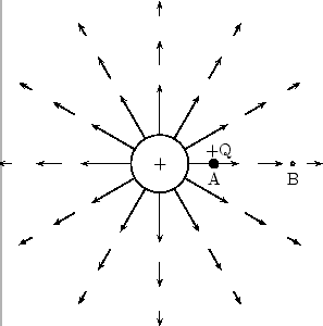

Electric potential is the work done in moving a unit charge from infinity to a point in an electric field.
Electric potential due to point charge:
[itex]V=-\int \vec{E}\cdot d\vec{s}[/itex]
[itex]V=-\int E\cdot ds cos \vartheta[/itex]
if the stationary charge is positive and
if the test charge is is moved from infinity to point P
then
[itex]V=-\int E\cdot ds cos 180[/itex]
[itex]V=-KQ \int \frac {1}{r^2} ds cos 180[/itex]
now how to solve further
as stationary charge is positive the electric field is outward i.e. from p to infinity
and movement of charge is from infinity to P
specially the signs and the direction of the field and the direction of ds
and definite integration from P to infinity or from infinity to P?
please give some imaginary picture or idea of how the test charge moves
I am confused with it please help.

If the angle between E and ds is 180o, then, where in what direction is ds directed?
from infinity towards Q
now i have attached an image in the original post
Yes, but how do we call this direction? It has a "special relation" to one of the variables in your equations.
it should have relation with
[itex] \frac {1}{r^2} [/itex]
Yes. How do we call a straight line starting from a point a going to infinity?
i imagined that it may be a straight line i.e. the shortest distance between infinity and P
This straight line is called a ray, and the direction is called radial direction. On it, [itex]ds = dr[/itex]. You need to use this.
I am confused with the signs and directions of ds ,dr and test charge and also
how work done by external element is negative of work done by electric field.
