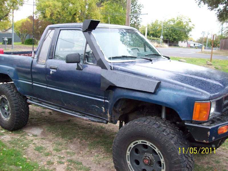

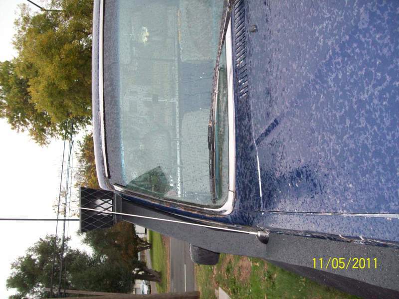

Travis-King I agree doesn't have to be exact.It's not a space shuttle lol.And the square let's me keep cross section smaller then round because the square edges get me more volume.(if it's to big it will impair my field of view)I leaned to the safe side with my calculated size so 2 1/2 should be slightly extra if anything.My truck is sort of fine tuned, highly modified so I don't want to hurt any performance.They do not make a snorkel for my truck because the motor in it is not factory.Otherwise yah I would have used something lab tested.I used metal because I can cut weld grind paint etc..I said its one straight piece for simplicity to my post but really it's more complex and has some water traps I intergrated in it.To separate water and snow.I will take a pic later and try to post it.So you all can see what your time has went into.Thank's again everyone.
Sorry for taking so long.This is what it look's like.It work's great no problems yet.Thank you everyone for the help.I have gotten some criticism and some complements on how it look's.Honestly I am not completley satisfied with the look's.I might change it.Feel free to comment on it good or bad.I like the honest input.Have a great day everyone.
