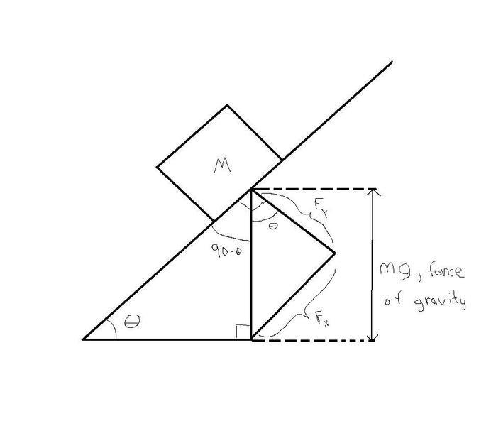

I have a problem where an object slidind on a incline plan.
I would like to know its weight but i 've found 2 formules(?)
P= m.g.sin θ
and
P= m.g.cos θ
Could you explain me how use them in the right way ?

Take a look at this ramp I drew. It shows how you can use the angle that the ramp makes with the flat floor to break the force of gravity into two components: the force normal to the ramp's angled surface and the force along the angle of the ramp.
[tex]F_x = mgsin(\theta)[/tex]
[tex]F_y = mgcos(\theta)[/tex]
Notice that the "x" component (along the angled ramp) uses a sin instead of cos. And the opposite is true for the "y" component (normal to the angled surface). These two equations are found through the definition of a cosine and sine of an angle, using the triangle I drew.
