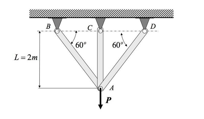

A pin-jointed frame (diagram attached) is formed of steel rods of 10mm diameter with member AC being 2m long. If a load of 50kN is applied at A as shown, determine the deflection of A and the force in the three rods. Take E = 200kN/mm^2.
FA→B = FA→D = FA→C* cos(30)^2
FA→C +2*FA→B cos(30) = 50kN
Our tutor has given the answers as:
FA→C = 21.7kN
FA→B=FA→D=16.6kN
And he has said FA→C = 50kN/1+2cos(30)^3)
But when I solve the equations in for FA→C I actually get= 25.6kN. can anyone help me find my error?
If you could show your working, you would get more help. Meanwhile, on what principles are the equations "FA→B = FA→D = FA→C* cos(30)^2" based?
At what point in your calculations has the compatibility of the displacements been made?
