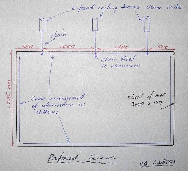

Thanks for the replies. An initial design consists of a sheet of 9 mm MDF, 3000 x 1775, weighing ~37 kgs with aluminium stiffening on the back. The screen will be indoors, supported from three chains attached to the aluminium stiffeners at the screen end, and to three exposed timber beams at the ceiling end. I imagine the screen to be hanging at a slight angle, with the back of the screen pushing against curtains that are already in place. See attached drawing which is drawn looking horizontally.
So basically the screen is hanging under its own weight. I assume it won't move around too much. If it does (somebody bumps it, for example, or drafts of air) I might tie it down to the floor with a bungee cord or somesuch.
What I am mostly concerned about is the board warping in the long term because of humidity/temperature changes throughout the year if it is left unbraced.

I guess you would get the best flatness with L-shaped stiffeners.
Also, just a 4 stiffeners around the outside will to little to keep the center from bulging, e.g. when the MDF expands due to humidity. I would probably go for some kind of grid structure on the back, with 30-50cm betwen struts and 25mm x 10mm Al profiles (the 10mm edge screwed to the MDF).
I just assumed that he knew what he was doing when it camed to the visibilty and quality of the picture on the MDF surface.
Thanks for the diagram that helped to see what you were talking about. You don't think a 9mm thick MDP board is a little over the top? If you really want to use it I'd just outline the back edges with some angled sections like M Quack suggested. Much cheaper than a huge plate of Aluminium. Not a good application for Al anyway.

I'm happy to help you with the equations, I'm a mechanical design engineer, but I think you're over thinking it. There's nothing to really to calculate. You'll find that the angled sections don't really differ much in price. I get stuff manufactured all the time. The smallest size will be way more than you need. Since it's just an inside application, I personally wouldn't even bother with the steel backing, with a 9mm thick board. I'd just buy one of the nice rollup ones so you don't have a gigantic hunk of plywood hanging around.
