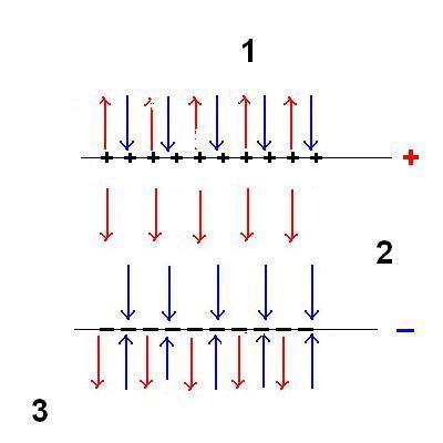

Connecting the capacitor to the battery, the potential difference across the capacitor becomes the same as the voltage of the battery (U). Accordingly, the charge of the capacitor becomes Q=CU. The charge on the capacitor plates are equal in magnitude and of opposite sign.
You can calculate the electric field outside and inside the capacitor, and you know that the surface charge density on the inner and outer surfaces of the plates are equal to ε0E.
The charged plates can be substituted by planes of charge, and the charge of unit area is σ on one plate and -σ on the other one. (If A is the area of a plate, σ=Q/A).
You know that the charge distribution causes the electric field strength Q/(2ε0) at both sides of a charged plane, and the electric field lines emerge from the positive charges and end in the negative ones.
The electric field in the different regions 1, 2 and 3 are obtained by superposition from the fields of the charge distribution of both planes.
The red arrows show the electric field lines from the positive charges on the upper plane and the blue arrows represent the electric field lines from the negative charges on the lower plane.
You can see that the field lines cancel each other outside the capacitor and the electric field is σ/ε0 inside, pointing downward.
