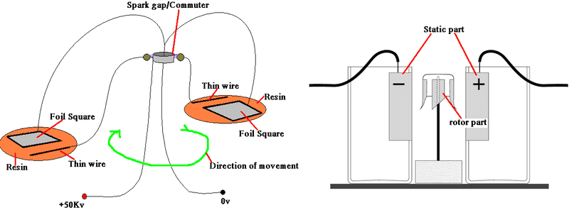

Dear all,
Could someone help me understand what is happening in this video...
Does it have any application in science or industry?
Many thanks,
Well it's really hard to tell something from such a messy video but to me it looks like a very inefficient and very very funky electric motor.
Ok forgive my ignorance if I missed something.
There is a commutator some sparking some wires and that's all looks like a very simple analogy of dc brushed motor.
Interesting... I did not think of that.
The problem is that there are no magnets, no induction coils and the wires carry '50Kv' at very low currents according to the owner of the video.
The resin contains a 'capacitor', I.E is a large foil disk that is connected to 0v - gnd - and a thin wire that is connected to +50Kv.

Coming back to the video in the OP... I suppose the only issue I have with it be an electrostatic motor in the conventional sense is the electrical layout or topology.
I've tried to draw just the wiring in the image attached so there is no structure, just the electrified bits. As you can see, the electrostatic motor to the right has a 'static part that is electrified and then the rotating part, while the setup in the video has no 'static' part to leverage against.
Which brings us to the thought that it is, as CWatters said, a 'lifter' variant. The issue here is the fact that the 'lifter' is encased in resin which should stop any ion displacement.
It is also, correct me if I am wrong, going in the opposite direction to what a lifter should...
