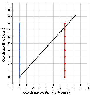

One of the best ways to comprehend Special Relativity is to define a scenario in an Inertial Reference Frame (IRF) and draw a spacetime diagram depicting the locations and motions of the various objects. I like to use dots to indicate the passage of time for each object which are placed farther apart when the object is moving according to the factor of gamma (1/√(1-v2)) where v is expressed as a fraction of the speed of light. At a speed of 0.9c, gamma is 2.294. So for your scenario it would look like this where Earth is shown in blue, the planet in red and the spacecraft in black:

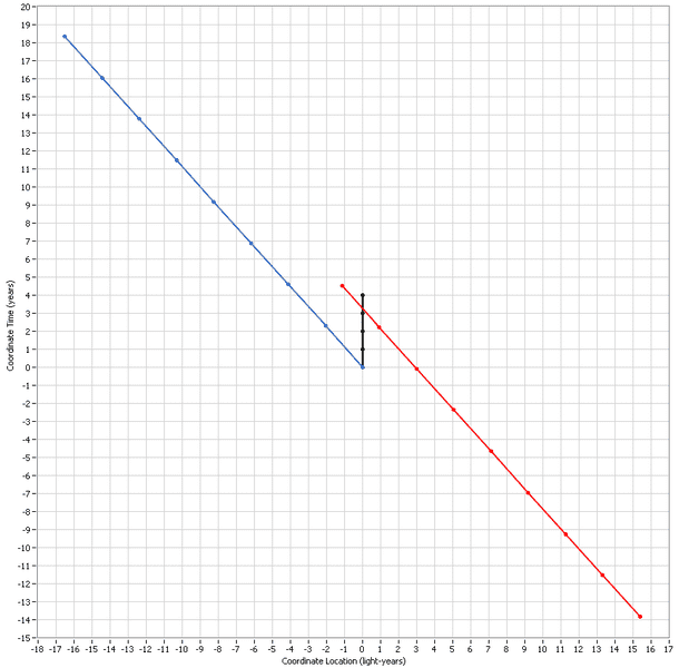

Now we can use the Lorentz Transformation process to calculate the coordinates of all the events (the dots) for a new IRF moving at 0.9c with respect to the original IRF which would be the rest frame of the space craft. Here is what the diagram for that IRF looks like:
You can see at the Coordinate Time of 0, the distance between the Earth and the planet is slightly less than 3 light-years and the planet and the Earth are the ones moving at 0.9c while the spacecraft is stationary.

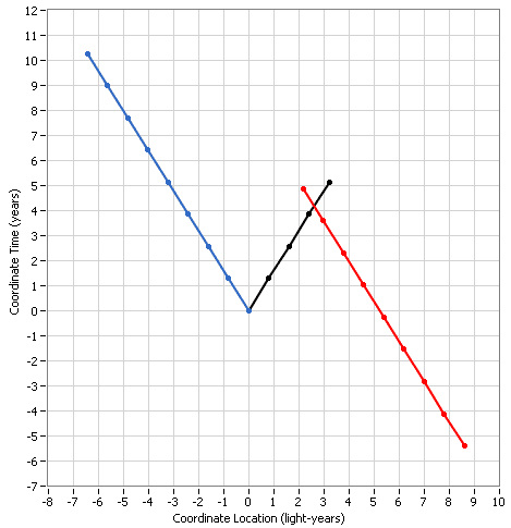

Now we can also transform the scenario into any other IRF moving at any speed (short of c) with respect to the defining IRF and even though the objects can have new time dilations and new distances between them and new speeds, they will all show that the clock on the spacecraft progresses through 3.253 years during the course of the trip. For example, I picked another IRF where the Time Dilations of all three objects are identical. This happens with the IRF moving at 0.627c with respect to the first one:

You don't have to introduce more than one Inertial Reference Frame as I showed in my previous post, any IRF will do, but you have to use Time Dilation for any object that is moving, otherwise when you transform to the IRF in which that object is at rest, its clock will not be ticking at the same rate as the Coordinate Time.
Also, you should not think of some observers or objects as being in particular IRF's. Everything is in every IRF. You should also not think of any particular IRF as being preferred. Of course, you need to start with one IRF so that you can define your scenario, but after that, you can transform to any other IRF. No IRF is better than any other IRF.
