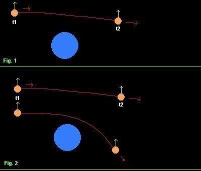

Curious about gravitational sluing detail
The discussion centers on the gravitational interaction between a non-rotating rock and a planet during a slingshot maneuver. Participants explore whether such an encounter would impart any rotational motion to the rock, concluding that the rock would not gain additional angular momentum if it starts as non-rotating. They emphasize that the rock's shape and density distribution are crucial factors in determining any potential rotation. The conversation also touches on the effects of tidal forces and the nature of gravitational interactions, suggesting that without external torque, the rock's angular velocity remains unchanged. Ultimately, the consensus is that a perfectly spherical rock would not experience rotation due to the slingshot effect.
bowlegged
Let's say a big rock is headed toward a small moon, impelled only by existing momentum and gravitational pull. The rock is not rotating or tumbling at all, leastwise not in relation to the local time/space norm. The rock is sped up by the moon's gravity and it falls ever faster and faster. But the rock just misses crashing into the planetoid, which BTW has no atmosphere, and the diving rock gets slued around the much bigger entity and careens (slingshots) off on a greatly altered trajectory. My only question is, wouldn't such a momentous encounter tend to impart some spinning/tumbling feature to the runaway rock? (And can you prove it?)
Many thanks.

If a spacecraft is in orbit around the planet such that the orientation of the spacecraft is that its belly always faces the planet (the view out the front window will always show the planet below and space above), then the pilot of this craft will measure that he is not rotating - his craft is not tumbling.
An observer floating a ways off will measure the craft as tumbling, making one rotation per orbit.
Likewise, if the craft is oriented so that its long axis is aligned to its line of sight to a distant star and this long axis is parallel to the orbital path twice per orbit, then the pilot will measure a tumbling rotation, one per orbit, and a distant floating observer would measure that the craft is not tumbling.
All this just to examine what it means for a craft or rock to be said to be tumbling when orbiting, passing, sling-shotting, or crashing with respect to a planet.
I'm assuming that what you mean by local time/space is that the rock or craft is following its local geodesic straight non-rotating path and orientation. From this perspective there is not rotation or tumbling, only non-accelerated linear translation in a local straight line.
That said, from the rock's perspective, since it is not seeing itself as tumbling initially (it has an axis that maintains alignment with the path of its orbit), even as that path begins to curve around the planet and then uncurve, that alignment will maintain to that curvature... and no local measurement of the rock will find a rotation component with respect to its orbital path.
Yet, clearly there has been a rotation with respect to the distant stars. So there are really two questions; what really constitutes a rotation and from which vantage point is it being measured, and (to what I think you are asking) does any rotation during the maneuver stay with the rock as an additional angular rotation - does an initially "non rotating rock" become a "rotating rock" after the sling-shot maneuver?
I think the answer to this second question, from both the rock's and a floating observer's perspectives must be "No".
The rock will see the universe rotate about it during the maneuver but will be unable to measure anything local that would be a rotation with respect to its path.
The floating observer would see the rock begin to slowly rotate so as to keep its same orientation to its orbital path, and this rotation would speed up as the rock approached its closest point to the planet, then the rotation would slow as the rock left the planet, and with sufficient distance from the planet the rotation would approach zero; the whole rotation amount being the inner angle of the asymptotes of the two long arms of the approach and departure paths

Gravity effects the centre of mass of the rock.
But now consider two rocks, separated, but traveling on different parallel initial paths. Each will travel an independent path. They would have very slightly different final paths after the encounter. So if the rock was now modeled as a long cylinder with two halves, each centred on one of those two points, it would change its astronomical orientation during the pass.

Consider two particles, traveling initially on different but parallel paths. Their paths are then deflected by the gravitational attraction of another body. One particle travels slightly further, the other a shorter distance, faster.
Does their mutual orientation relative to distant stars remain unchanged ?
Do they remain the same distance apart after deflection as they were before ?
(I am deliberately ignoring the mutual attraction of the particles here).
Yes.
No.
No. The reason can be found in Newtonian gravity, GR effects are negligible unless we consider black holes.
You can imagine an extreme example where one object is far away and does not get deflected significantly, while the other one makes nearly a 180°-turn.
Single rigid objects are not two objects moving independent, however - they have to follow a single trajectory with a fixed separation between parts of them.
No, that's why we cannot use them as a model.

That is a weird combination of answers. If the distance changes, then accelerations must have been different, so the orientation can have changed too.
My answers would be:
Yes & Yes if tidal forces are negligible
No & No if tidal forces are not negligible

I thought it would help to draw some pictures. Please excuse the horrible programmer art.
Red line is path/trajectory of rock.
Yellow arrow is rock’s orientation relative to the stars. This never changes.
In fig. 1 the rock is deflected by gravitation of planet, but its orientation to the stars (its rotation) remains the same.
In fig. 2 a second identical rock flies by the planet, but at a closer distance, so it is deflected more. They started out with parallel velocities, and ended up going in very different directions, but they did not rotate to align themselves to the path.
[Edit] Asumming negligible tidal and relativistic effects.
Did I get it right?
It can change if the rock does not have a spherical symmetry, as has been mentioned before.
  • #31
Yes, I know, if the rock is not perfectly spherically symmetric. Thats why I went back and edited the post and added "negligible tidal forces".
Besides, the amount of change in rotation of a non-symmetric rock would be extremely small. The poster in post #2 thought that the object would align with the path of deflection. That means in fig. 1 the object (whether symmetric or not) would have rotated several degrees. I was trying to correct that. Now I guess the point is hopelessly lost, but thanks anyway.
Honestly. Did you really think that was necessary? For once I wish we could just stick to physics.
Why do you do that?
  • #32
I think we talk about different orientations here. Baluncore was asking about the "mutual orientation" of the two test masses. I assume he means the orientation of the line connecting the two test masses. You are talking about the individual orientations of each test mass.
If the distance changes then the orientation of the connecting line can change too.
I'm not so sure about that, it would be interesting to find an upper limit.
If the same wrong things get repeated? I think it is useful.
