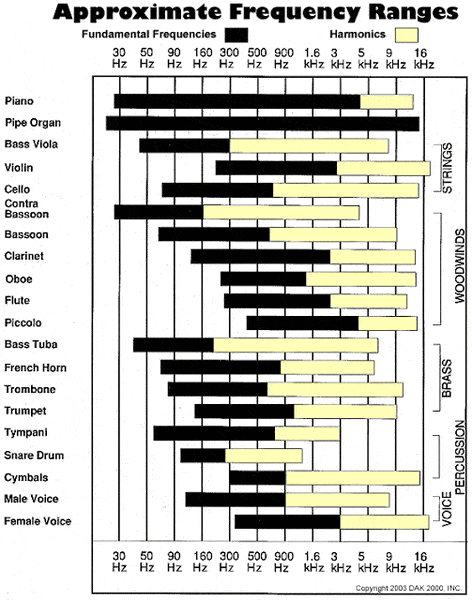

So I am making a color organ using my ipod, speakers, splitter, butterworth filters with gain for three separate frequencies. I want to have a low, mid, and high but I have no idea what the cutoff frequencies for each should be. I know we hear something like a band of 200 Hz to 20 kHz but I am totally not sure at all if that would be reasonable to filter an audio signal to separate bass, treble, and mid sounds. So my question is what cutoff frequencies should i use to adequately filter bass, mid, and treble with each of the three filters I am designing?

I'd probably suggest something like
Bass range: 0 - 120 Hz
Mid range: 120 Hz - 5 kHz*
Treble range: 5* - 20 kHz
* EDIT: On a second thought, I had some doubts; 5 kHz might be too high, maybe 3 or 4 kHz would be better, I'm not sure, I've never built any light organ. But I've done a lot of audio processing and I've built various audiohardware, so I'm probably not completely off :biggrin:.
The human hearing range is about 20 Hz - 20 kHz (not 200 Hz - 20 kHz) and with some individual variations. You can also google for "instrument frequency chart"; such charts can be helpful. I'm posting an example of such a chart here:
