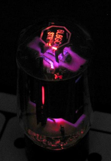

I was thinking of this phenomena:
which is visible in leaking vacuum tubes. The picture is by the way fetched from another thread of mine namely:

The 6L6 GC (pictured) is a guitar-amp valve
... it is not a vacuum tube as it contains gas (mercury vapor iirc).
Purple-pink and orange glows are part of normal operation - but I think it's supposed to be bluer than that.
A bad seal can produce a muddier pinkish-orange due to trace oxygen and nitrogen, as described for gas discharge tubes.

Quote Quote by Simon Bridge View Post
A 6L6 is a normal vacuum tube, the color in his tube picture is abnormal.

A 6L6 is a normal vacuum tube...
I'll take your word for it.
I wanted to make a distinction between a "vacuum tube" (I know them as "thermionic valve"s) and a "tube designed to have a vacuum in it" - reason: see context above. I don't know what you mean by "normal" in this context.
Maybe I'm just not being clear:
The 6L6GC I am thinking of is an audio-frequency power pentode - commonly found, these days, in electric guitar amp boxes. (see below)
You'll find a lot of chatter on the guitar amp groups about their blue/purple glow in operation.
The blue glow is characteristic of tubes using mercury vapor as opposed to a simple vacuum action.
Without the vapor, the only part that should glow at all is the heater (on the cathode).
But I don't have one handy to check - so I could be mistaken.
I do have my own refs though:
A FAQ: http://www.rru.com/~meo/Guitar/Tubes/blue_glow.html
... also see specs.
http://www.tubeampdoctor.com/images/...2008.07.11.pdf
... notice the pic shows a clear orange glow from the heater? The purple tinge is not evident though.
I believe the Sylvana Engineering Data Service reference in FAQ is available in docstoc:
http://www.docstoc.com/docs/81418143...g-data-service
... the color in his tube picture is abnormal.
I agree - it should be bluer - you wouldn't normally get the 6L6GC with argon or neon, which is the other way you see pinky or reddish glows in the gas.
There are plenty of pics of the tube in normal operation - you'll see that the exact color of the glow varies with manufacturer and use.
I don't see a disagreement.
Link reference needs to be more specific
... don't know what it is supposed to show or which part you are referring to.
I don't think we are actually disagreeing though: if you've got a better answer to OPs question, I'd love to hear it... it's why I'm here after all...
Not much of a disagreement really but a clarification.
Normal in this case would be a "6L6 type thermionic valve" with very little residual gas. When I was younger I rebuilt a quite a few tube audio amplifiers. (some were even for guitars ) Mercury vapor tubes were normally only seen in the rectifier sections or as power switches as they are very non-linear.
As I was explaining in the other thread the 'normal' blue glow in receiving type tubes is not from gas ionization, it's from FLUORESCENCE per your link:
Q: "Does the blue glow mean my tubes are 'gassy'?"
A: No. Gassy tubes are characterized by excessive grid currents and other poor performance characteristics. Extremely gassy tubes may glow with a pinkish cast throughout the entire tube. A faint blue glow on the glass, or inside the plate structure is completely normal. In fact tubes exhibiting this glow are frequently lower in residual gas.
