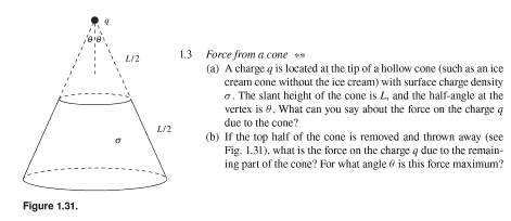

The problem states: A charge q is located at the tip of a hollow cone (such as an ice cream cone without the ice cream) with surface charge density \sigma. The slant height of the cone is L, and the half-angle at the vertex is \theta. What can you say about the force on the charge q at the top of the cone?

For reference, here is the question. Note that for (a) you are asked, "what can you say about the force"? The wording implies that you might not be able to actually find the force for this part.

Ah, sneaky. My hope was the divergence wouldn't be bothersome because the area and thus the charge would go to 0 fast enough. Not so. Stating that it's infinite and pointing straight up is unsatisfactory!
