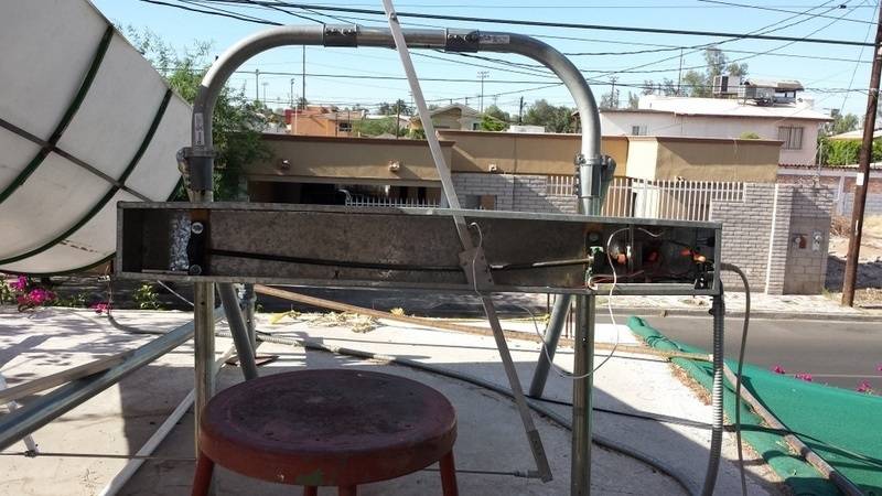

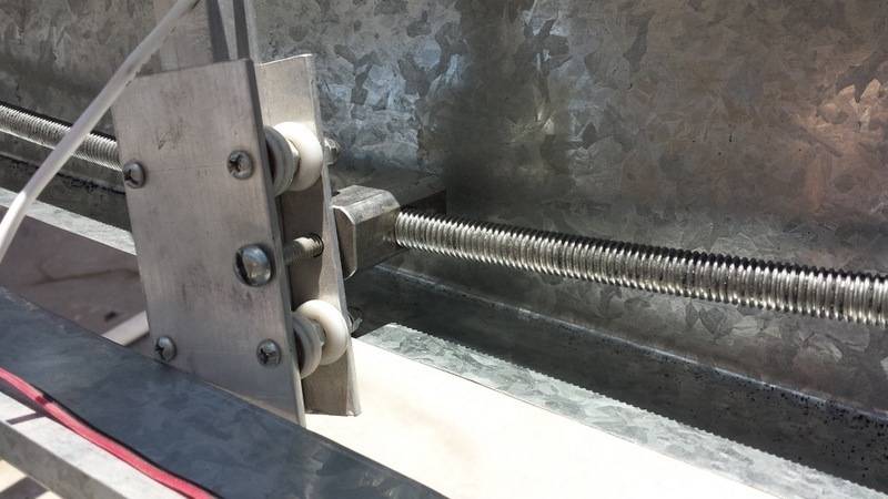

We are working on an electronic solar hot water heater.
We had it working but decided to change the way the aluminum tube was connected to the frame by running a 7" bolt through both the alum tube as well as the support (see photo 02, bolt at top). We thought that it was going to act as a pivot but, now, when we try to run the heater the 3 ft. threaded rod wants to bend/deform. We've already gone through two plastic/rubber spiders linking the threaded rod to the 1 amp motor.
Since we are not mech. engineers we don't have a clue as to what is causing this thing to get bent out of shape.
Any help would be greatly appreciated. If you need more details, pics, etc. please just ask.

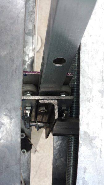

The rod/alum tube is free to slide in the bracket you've made with the plastic rollers? Doesn't look like it. I'd check how tight that bracket is against the main rod. If you look at picture 2, I would venture to guess that as the bottom of the pivoting rod moves left, the sliding bracket on the positioner is clamping the rod and being displaced downward (following the arc of the rod about it's pivot).
A three foot span requires very little force at the center to deflect it.
I would also check horizontal alignment. Everything should be moving about the same vertical plane.

Ideally the rod should be touching only the rolling surfaces. It should not come into contact with the plates.

O.k., i went upstairs this morning and disassembled the rod and slider (i guess that's as good a name for it as anything). i also removed the poor threaded rod. i'll have to buy another one since it's permanently bent. You were correct Travis_King -- the inside of the aluminum slider plates presented scratch marks where the rod scraped against them.

That would probably work. But you may be able to make your design work as well.
Your two main issues are this:
1. As you know, you've got to stop the bar from binding. You could add some slide-plate material in the slider to facilitate this. But more likely you'll need to redesign the slider in such a way that the rollers rotate freely and easily (from the looks of the first picture, the rollers seem to be rubbing on the plates as well). You also need to ensure that all faces of that rod are touching rolling surfaces. Or buy one of those things and a new round connection rod, that would work and might be easier and cheaper in the long run.
2. All of the loads are being transferred through that threaded rod. In similar mechanisms, the slider is typically mounted on one or two high strength rods/beams (above and below the threaded rod) so that the only forces the threaded rod sees are axial. Basically this idea (in principle) ]

How was it originally mounted?
Was it fixed to pivot there before?
How is the threaded rod attached to the guide? Are threads on the guide fixed or allowed to rotate to compensate for the angle of the tube?
It looks to me like the guide stays aligned with the tube as the angle between the tube and the threaded rod changes, so if your threads on the guide are welded square (fixed and won't compensate for the angle of the tube) they will pinch/bend/torque the threaded rod. On your picture here (http://www.appropedia.org/File:Aluminum_guide.jpg) the guide is nice and square with the threaded rod, yet on the one you posted on the thread, there's a nasty angle between them.

At this point we're trying to do away with the rectangular contraption with the little plastic wheels and are trying something else. We're just going with the long alum. tube. The threaded rod has a 2" steel piece threaded on it which has a 1/4" threaded hole in it. We're trying to make a 1/4" x 6" channel in the alum rod through which we will run a long 1/4" bolt which will loosely bolt it to the steel piece. i need to find some place around here that can finish the channel that I've started with a bunch of 1/4" holes using my inexpensive drill press.
As some sort of clarification, the rectangular piece in the photo has a bolt in the middle of the right hand side. It's the same bolt we'll be using but instead of using the rectangular contraption, we'll just run it through the alum rod - hopefully - lol.
I think that will work. That'll take care of the angle problem and the variable distance.

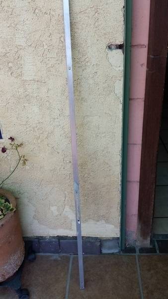

Well, it's Wednesday - i went up the street about 6 blocks to the local iron-worker (he also bent our parabolic ribs) and he had a machine with what looked like a one foot, thin abrasive wheel on it and made short shrift of the holes i had made, creating the channel on both sides. Cost: $2.00 and an explanation of the heater. Foto below.
i still need to file down a couple of places, but it was worth it. Now on to connecting the lower part/extension where it will connect to the parabola and setting it into the box, running the sun seeker wires up the rod and reconnecting everything.

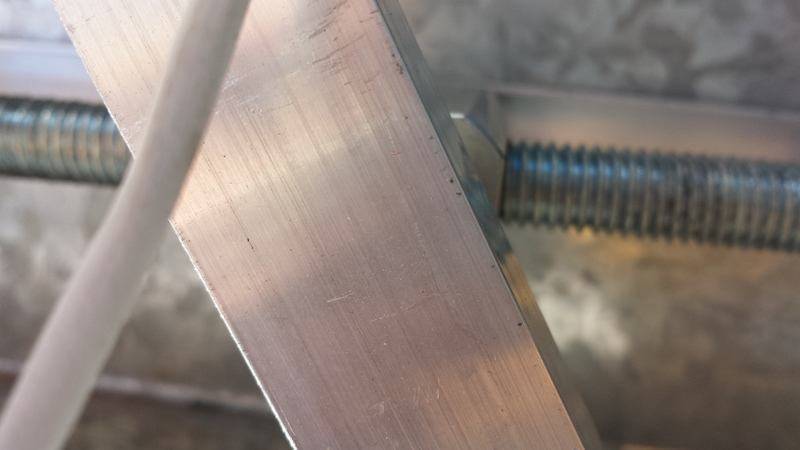

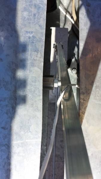

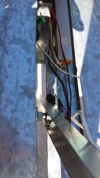

Finally came up with a design which seems to work better. My son and i decided that what we had was too complicated, so we purchased an 8 foot long aluminum channel at Lowe's and used about 4 foot for the vertical part and about 3 feet to be attached to the back of the metal box to receive the other bearing.
So, the steel block that rotates around the threaded rod now has two 1/4" threaded screws protruding. Each of these screws has a bearing on the end (and some separaters so that the bearing stays in the aluminum channels). Much simpler and seems to be working just fine now. See photos below. VERY happy camper. This one has been a real head-breaker.
Thanks again for all your imput and support. Well be closing this thread (evidently this type of forum doesn't allow editing of the first post so we could put SOLVED in it...).
Have a great afternoon! :)
P.S. The first photo is a photo of the last iteration - very complicated.
Second photo... Looking down through the top of the metal box. On the left is the steel block with the threaded rod (not seen).
Third photo... Looking at the front of the metal box (w/o lid) at the vertical aluminum channel in the foreground, the steel block and threaded rod and almost invisible in the background, the horizontal aluminum channel.
Fourth and fifth photos... Looking down again at the metal box, a tiny bit of the steel block on the left and a better photo of the protruding 1/4" thread with the bearing and "separaters". In the fifth photo can be distinuished a nut on the end of the 1/4" thread. Probably need to switch the bearing for the nut so the nut doesn't scrape against the aluminum channel.
