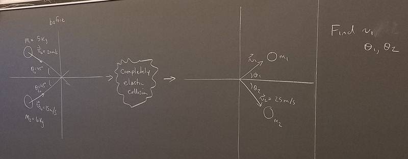

Mass 1 has a mass of 5kg and is traveling with an initial velocity of 20 m/s at a 45 degree angle. (Starting in Quadrant II and heading toward the origin.)
Mass 2 has a mass of 6kg and is traveling with an initial velocity of 15 m/s at a 45 degree angle. (Starting in Quadrant III and heading toward the origin.)
The final velocity of mass 2 is known and it is 25 m/s after the collision.
The collision is completely elastic.
I need to find the velocity of mass 1 after collision, and the final angles of both masses.

Are you sure all of the values in the problem statement are correct? Maybe I messed up on the calculations, but it looks like the final kinetic energy of m2 is greater than the initial kinetic energy of m1 + m2.
Well, I copied the problem down as it was written on the board. I even took a picture of the chalkboard to make sure I didn't make any transcription errors. This problem was not out of the book ... it was made up as a take-home practice problem.
Yeah, the more I think about it, the more I am convinced there is a problem with the problem. I just don't think it's possible for m2's speed to increase from 15 m/s to 25 m/s due to a collision of a lesser mass object traveling at 20 m/s.

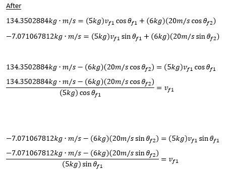

For x, I'm getting that the total momentum before is (100kgm/s)*cos(45)+(90kgm/s)*cos(45)≈134.3503, that seems reasonable. (I think.)
But for y, I'm getting what seems like nonsense. (100kgm/s)*sin(-45)+(90kgm/s)*sin(45)≈-7.0711
Does it make sense that the y momentum (before) would be negative?

Ok ... thanks for clearing that up, but I still have a problem with too many unknowns. (I don't know the equation editor here well enough to make this clear, so please pardon the photo equation.)
If I assume that my √190m/s (or ≈13.78m/s) velocity for mass 1 after is valid (from post #10), then I still can't solve the angles.
Back in post #10 you solved for Vf1, so that is a known. If you look at your two equations in the form they were just before you solved them for Vf1:
On the right hand side of the x momentum equation you have 5vf1cosθ1
And on the right hand side of the y momentum equation you have 5vf1sinθ1
If you square both of those equations you can then add them together and use the trig identity sin2 + cos2 = 1
That will eliminate one of the variables.
BE CAREFUL of your signs though. The picture shows the final velocity of m2 in the downward direction. Is that how you are defining it? That seems to be the most straightforward.

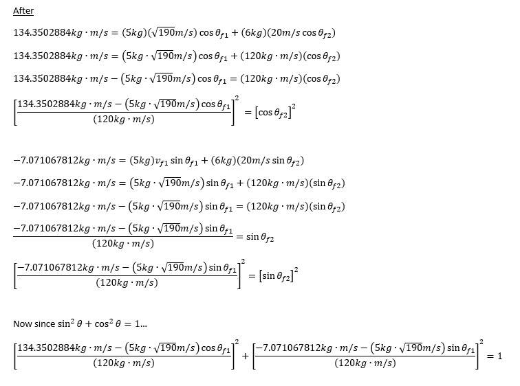

Ok, I'm trying to wrap my head around this ... below is what I've done based on this new information. But I'm not seeing how this eliminates a variable. I now just have an insanely complicated equation with two unknown angles. (I'm sorry to be so dumb at this. This is my first experience with physics.)
I did not go through your whole equations, but in your final equation (above), it looks to me like you eliminated one of the variables - namely, θ2.
So you are left with a single equation with a single variable (θ1). Once you manipulate all of that, I think you should end up with an equation in the form:
asinx + bcosx = c.
http://mathforum.org/kb/servlet/JiveServlet/download/206-2697091-9755226-1202710/sin-cos-eqs.pdf
Example IV in the link above shows how to address that.

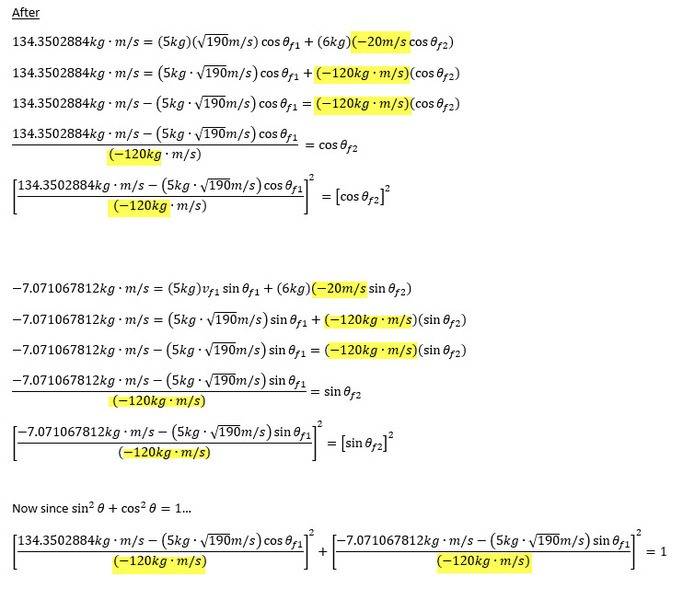

Check your sign in your initial y momentum equation. If you are defining the velocity of m2 in the downward direction, that term should be negative. (Edit: Replaced the word 'expression' with the word 'term'.)

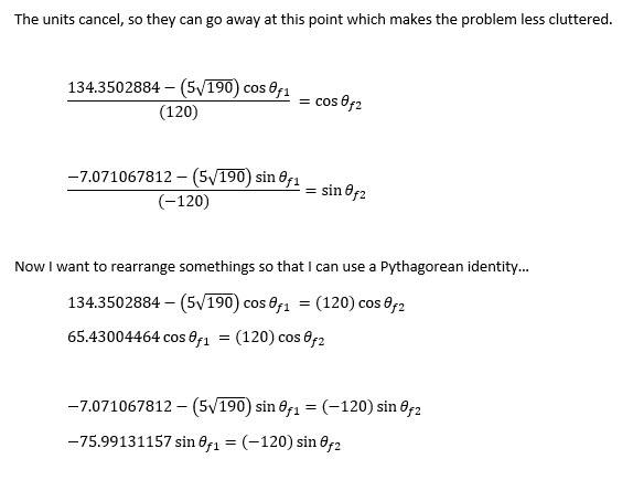

You're actually not that far away. First of all, when you write those equations, eliminate all of the units (kg, m/s, etc.).
Then multiply the whole equation by the 120 on the bottom. Then multiply out the squares inside of the parentheses on the left side. If you notice, when you multiply those out, 2 of the terms will be (25)(190)cos2θ1 and (25)(190)sin2θ1. Those reduce to (25)(190) because of the sin2 + cos2 = 1 trig identity. So you should be left with an equation of the form acosx + bsinx = c.

You should get into the habit of solving problems entirely symbolically as far as possible. Use variable names instead of the given numbers. It has many advantages.
Having found the second exit speed, you have two momentum equations. Writing just p for each mv product:
##p_{0x}=p_1\cos(\theta_1)+p_2\cos(\theta_2)##
##0=p_{0y}=p_1\sin(\theta_1)-p_2\sin(\theta_2)##
We need to come to one equation with only one angle in it. To do that, write each in the form ##p_2f(\theta_2)= ...##. Squaring and adding eliminates θ2 (and p2).
See if you can figure out what to do from there.

By the way, I still don't even think this problem is possible in the real world. How can a lighter object with a speed delta of +5 m/s (relative to the heavier object) increase the velocity of the heavier object by 5 m/s?
By far the easiest way to deal with such collision problems is to first transform them into the so-called center of momentum (CM) frame, look at the final velocities in that frame, and then transform those back into the original (lab) frame. I will go through most of the steps; I don't think this would volate PF policy, since you have already solved the problem.
Denote the initial lab-frame velocities of particles 1 and 2 by ##\vec{v}_{i1}## and ##\vec{v}_{i2}## and the initial lab-frame momenta by ##\vec{p}_{i1}= m_1 \vec{v}_{i1}## and ##\vec{p}_{i2} = m_2 \vec{v}_{i2}##. The total initial lab-frame momentum is ##\vec{p} = \vec{p}_{i1} + \vec{p}_{i2}##. Of course, this is also the total final lab-frame momentum, because of momentum conservation.
The CM frame is a new coordinate system moving at a constant velocity ##\vec{V}##, so that in the CM frame the initial velocities are ##\vec{u}_{i1}= \vec{v}_{i1} - \vec{V}## and ##\vec{u}_{i2} = \vec{v}_{i2} - \vec{V}##. (This just uses the standard kinematics of transforming velocities between frames in constant relative motion.) The CM frame is the one in which total momentum = 0. That means that ##\vec{p} - (m_1+m_2) \vec{V} = \vec{0}##, or
$$\vec{V} = \frac{m_1 \vec{v}_{i1} + m_2 \vec{v}_{i2} }{m_1+m_2}. $$
Now comes the clincher: in the CM frame, the individual particle speeds remain the same before and after a perfectly elastic collision. (This follows from conservation of total kinetic energy.) So, in the CM frame, the final speed of particle 2 is the same as it was initially, before the collision. Also, in the CM frame the two particles are heading in exactly opposite directions. After the collision, the deflection angle can be anything from ##0^o## (for a glancing collision in which the particles just barely touch) to ##180^o## (for a head-on collision, in which each particle bounces back). If we let ##\omega## be the initial angle and ##\theta## be the deflection between ##\vec{u}_{i2}## and ##\vec{u}_{f2}## we have ##\vec{u}_{f2} = |\vec{u}_{i2}| (-\cos(\omega + \theta), \sin(\omega +\theta))##. (Here we choose the direction vector to agree with the initial velocity when the deflection angle is zero, so the final angle is the same as the initial angle.)
By the way, the deflection angle is limited in the lab frame even though it is unlimited in the CM frame.
Now we can transform that back into the lab frame to get the final lab-frame velocity of particle as ##\vec{v}_{f2} = \vec{u}_{f2} + \vec{V}##, and we can get the final lab-frame speed as ##|\vec{v}_{f2}|##.
For your data we have ##\vec{v}_{i1} = (20/\sqrt{2},-20/\sqrt{2})##, ##\vec{v}_{i2} = (15/\sqrt{2},15/\sqrt{2})##. The total momentum is ##\vec{p} = (95 \sqrt{2}, -5 \sqrt{2})##, and ##\vec{V} = \vec{p}/(m_1+m_2) = (95\sqrt{2}/11, -5\sqrt{2}/11)##. We have
##\vec{u}_{i1} = \vec{v}_{i1}- \vec{V} = (15 \sqrt{2}/11,-105 \sqrt{2}/11) ## and ##\vec{u}_{i2} = \vec{v}_{i2} - \vec{V} = (-25 \sqrt{2}/11,175 \sqrt{2}/11).##
The initial speed of particle 2 in the CM frame is ##S_{CM,2} = |\vec{u}_{i2}| = 125/11##, so ##\vec{u}_{f2} = (125/11)(-\cos(\omega), \sin(\omega))##. The final lab-frame velocity of particle 2 is ##\vec{v}_{f2} = \vec{u}_{f2} + \vec{V}##.
We can determine ##\omega## from the direction of ##\vec{u}_{i2}##: ##\omega = \arctan(7)##. Substituting that into the above and expanding ##\cos(\omega + \theta)## and ##\sin(\omega + \theta)## we get the final lab-speed of particle 2 as
$$S_{LAB,2} = (5/11)\sqrt{1349 - 260 \cos(\theta) + 1320 \sin(\theta)}.$$
This has a maximum value of about 23.59 m/s, when the deflection angle in the CM frame is about ##\theta = 101.143^o##.
So, indeed, in the lab frame the heavier particle can be going faster after the collision; on the other hand, the lighter particle is going much slower after the collision. You can work the details for particle 1.
So: believe it or not, this way of working things out is about as simple as it gets! With a bit of practice, it becomes almost second-nature, and it removes a lot of the uncertainty about how to deal with the effects of deflection angles and the like.
