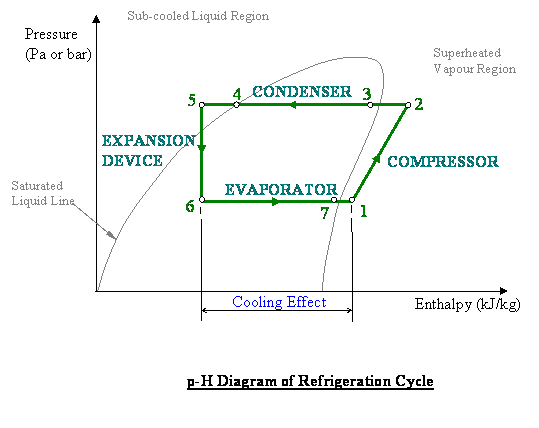

This is maybe where looking at the diagram will help:
Enthalpy is the horizontal scale at the bottom. The horizontal distance between 1 and 2 is much smaller than the horizontal distance between 2 and 5. So the heat of compression is only a small fraction of the total energy given away in the condenser.
Where is this energy going then? We are talking about internal energy right? In Joule Kelvin effect, isn't this internal energy just redistributed between potential and kinetic of the refrigerant molecules such that potential energy goes up and kinetic goes down and thus temperature goes down. This means that total energy stays the same even though temperature goes down.
The answer you got wasn't well put: yes, as you can see from the diagram above, the enthalpy is constant in the expansion. Just the temperature changes.
