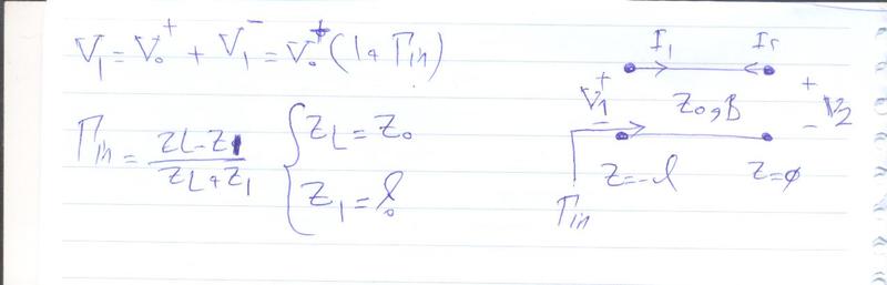

Hello

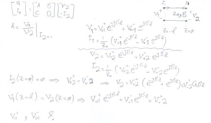

I want to obtain ABCD matrix element value.At first I tried to find A element value with boundary conditions but I don't know how can I find relationship between V(1)+ and V(1)- .
Any help appreciate
Do you know how to determine the reflection coefficient ρ at position 1? 'Cause that's what Vo1-/Vo1+ is.
A convenient way to find ρ is to put the source at z = 0 and the load at z = L where L is the physical length of the transmission line.
Likes baby_1
Thank you dear rude man

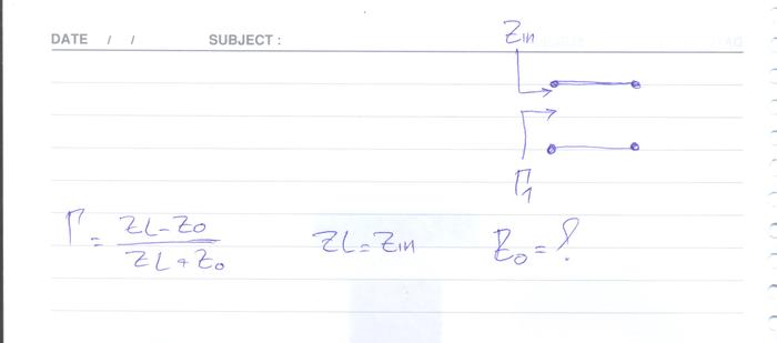

Before post this thread I think that I can use reflection coefficient too but as you know I don't have any other information before point 1 and my Z0 in this equation is unknown.
In post 1 you seem to state that Z0 was known. Anyway, it has to be known or you can't find the abcd parameters.
Thank you for accompany me
Here is my question we don't have any information before Point 1(Z1) how can define relationship between V+ and V-?
I'm having trouble understanding what you say and what you write.
Let me instead suggest:
V1 = V2+e + V2-e-jθ
V2 = V2+ + V2-
Γ2 = V2-/V2+ = (Z2 - Z0)/(Z2 + Z0).
Z2 = V2/I2
You can eliminate the + and - waves using the above.
And there are similar equations for I1, I2+ and I2-.
You wind up with
V1 = AV2 + BI2
I1 = CE2 + DI2
where A, B, C and D contain only θ and Z0.
