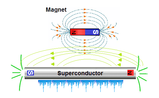

A superconducting material would work better. It would also be slightly more expensive.
Any magnetic field would be reflected from the zero resistance surface. That is because the eddy currents induced in the surface would generate a magnetic field that exactly countered the applied magnetic field.

An electric current flows in the surface of a superconductor due to an incident magnetic fields.
That surface current causes another magnetic field that cancels the incident field.
A perfect mirror makes a perfect shield. There is no current or field inside the superconductor.
But beyond the edges of a mirror there is no shield so the field can wrap around.
http://en.wikipedia.org/wiki/Magnetic_levitation

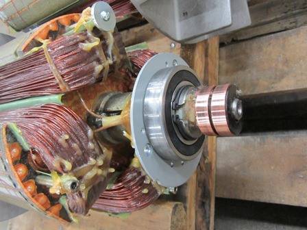

It's a practical consideration not a theoretical one.
The word "Stator" implies it's the stationary part
and "Rotor" implies the rotating part
the distinguishing terms should be "Armature" and "Field",
Field being the element that creates a magnetic field
Armature being the one whose conductors are cut by that magnetic field , and the armature is where the conversion from mechanical to electrical energy occurs.
All you need is relative motion between magnetic field and the armature turns.

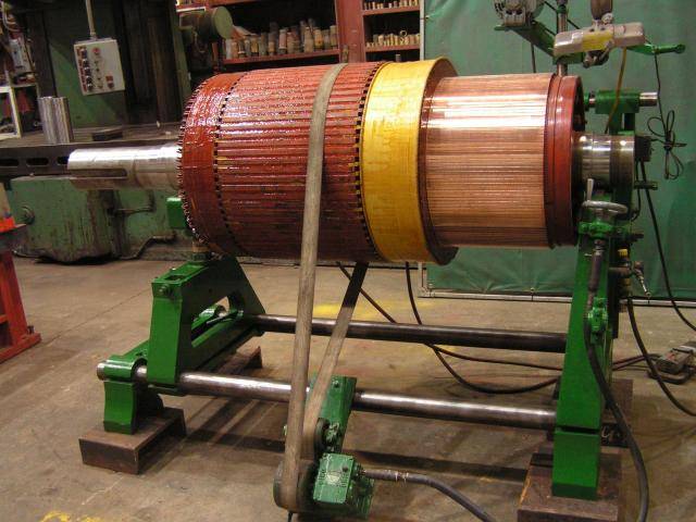

Either one of them can be the rotor. Indeed in the 1880's machines were built both ways.
It turned out more practical in AC machines to let the field be the rotor because field power is so much less than armature power which means your sliding contact can be much smaller.
Here's the commutator for a DC machine where the armature is on the rotating part
courtesy http://www.rsicorp.net/electric-motor-repair/commutator-undercutter-machine-dc-motors-armatures
Compare to the slip rings for a comparable alternator where the field rotates:
courtesy http://www.wincogen.com/HowGeneratorsWork
Take apart an old car alternator, then an old car generator(if you can find one).
I remember when we had to replace generator brushes at about thirty thousand miles, ~same as ignition points.
